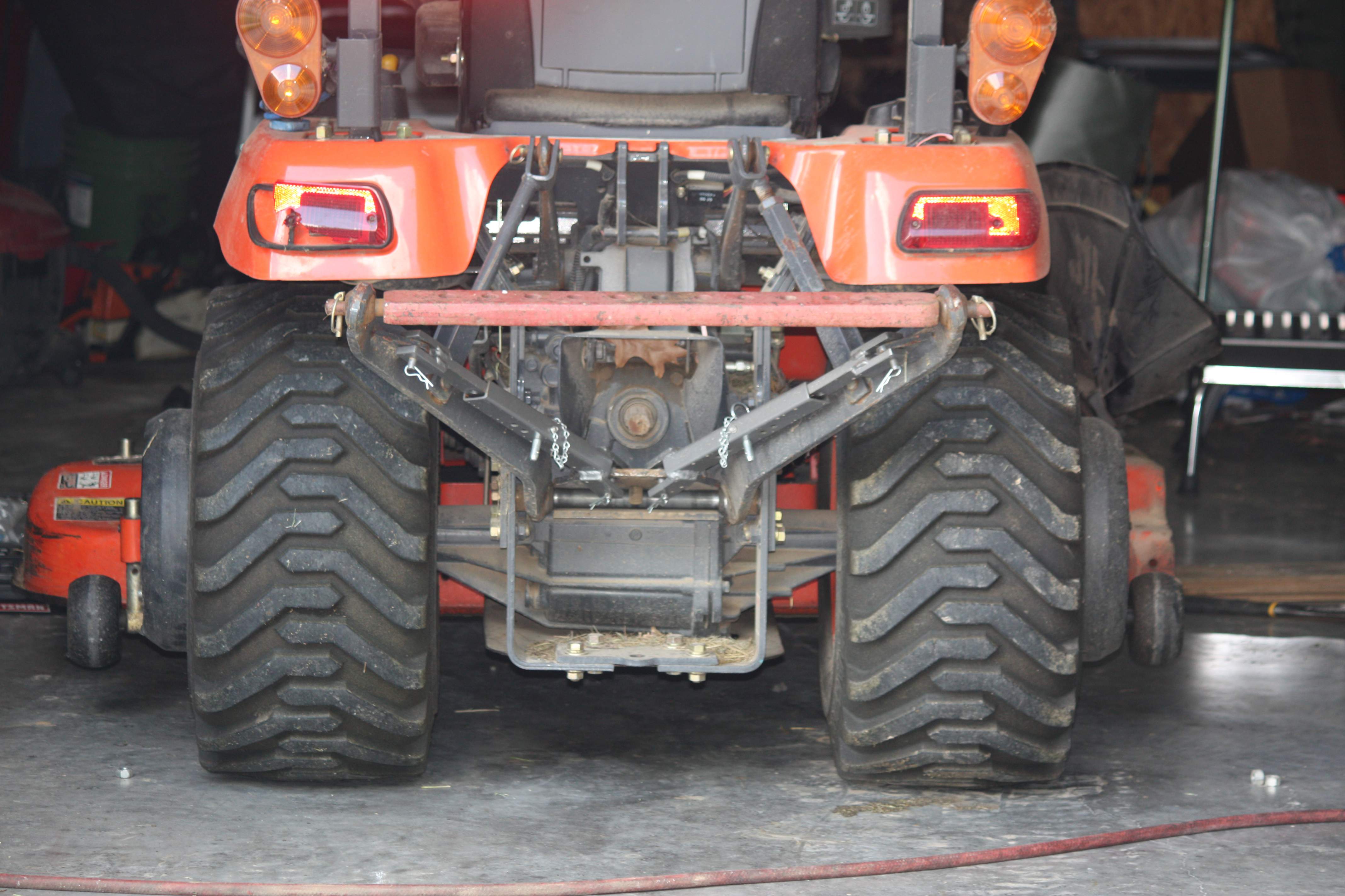

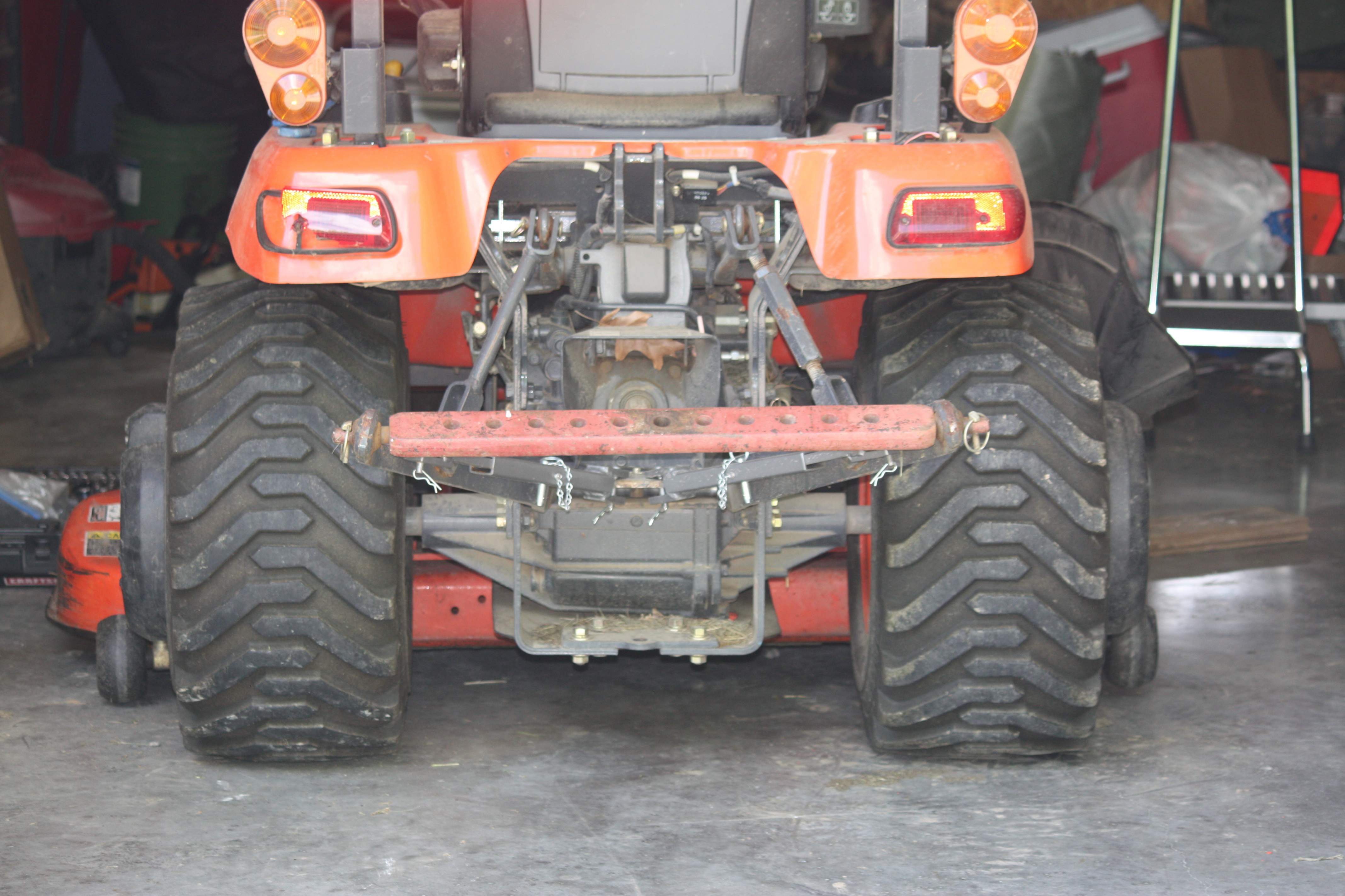

Adding the spacers is really as easy as changing tires a couple of times as they are bolt on.
I don't see a problem using weights and fluid, I have that on my L5740HSTC, I just haven't needed it on my BXs, one has fluid and one weights.
