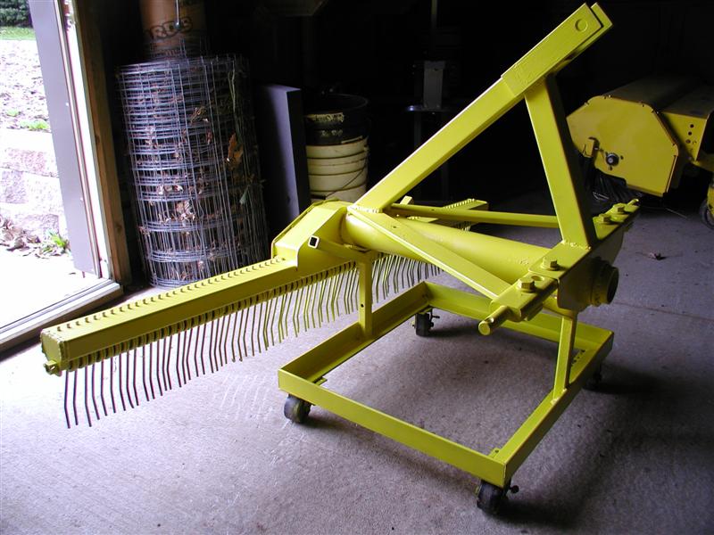

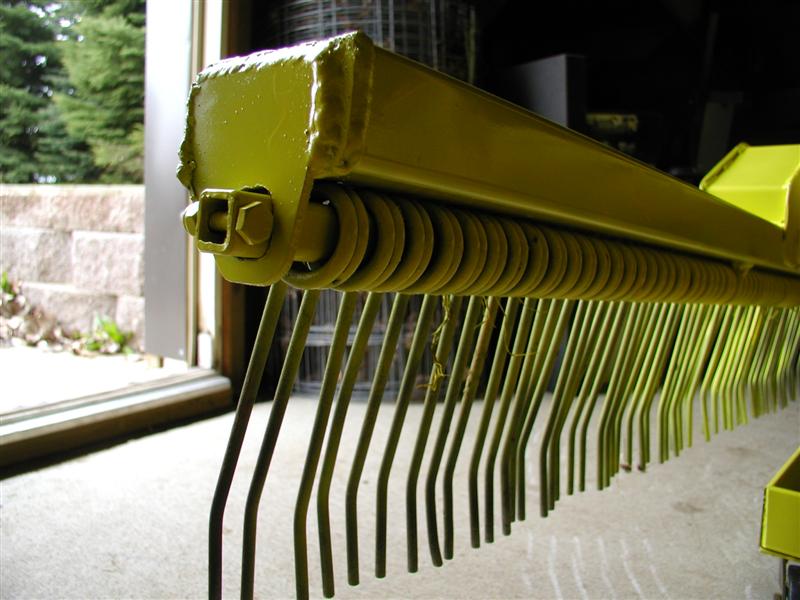

   / Loads of Fallen Apples - How to Pick up? #34
I rake mine together into a loose pile with this homemade "liteweight rake" (attached photo). Then I park the loader bucket downhill and hand rake them encouraging them to roll into the bucket. The liteweight rake is built with old swather spring teeth, so they are not too hard on the turf. And the tine beam can swivel nicely so it follows the landscape. I can use it while backing up the tractor, to avoid crushing apples. It also works well for those beans off the tree, and leaves, and sticks that are left from dropping a tree. Also have used it on the gravel driveway. It is shown in the picture setting on its castered-stand.

Andy - I thought there was something like that on the market, but I didn't know what it was called. Thanks for the link.
Jim - that is a very nice looking rake you built, and with a matching rolling stand to boot! I'm impressed.:cool: I'm glad to hear that it works so well for you with apples. I'll have to keep my eyes peeled for materials to build something similar, although I can pretty much guarantee that it won't be as nice as yours. Thanks for the idea and pics.
