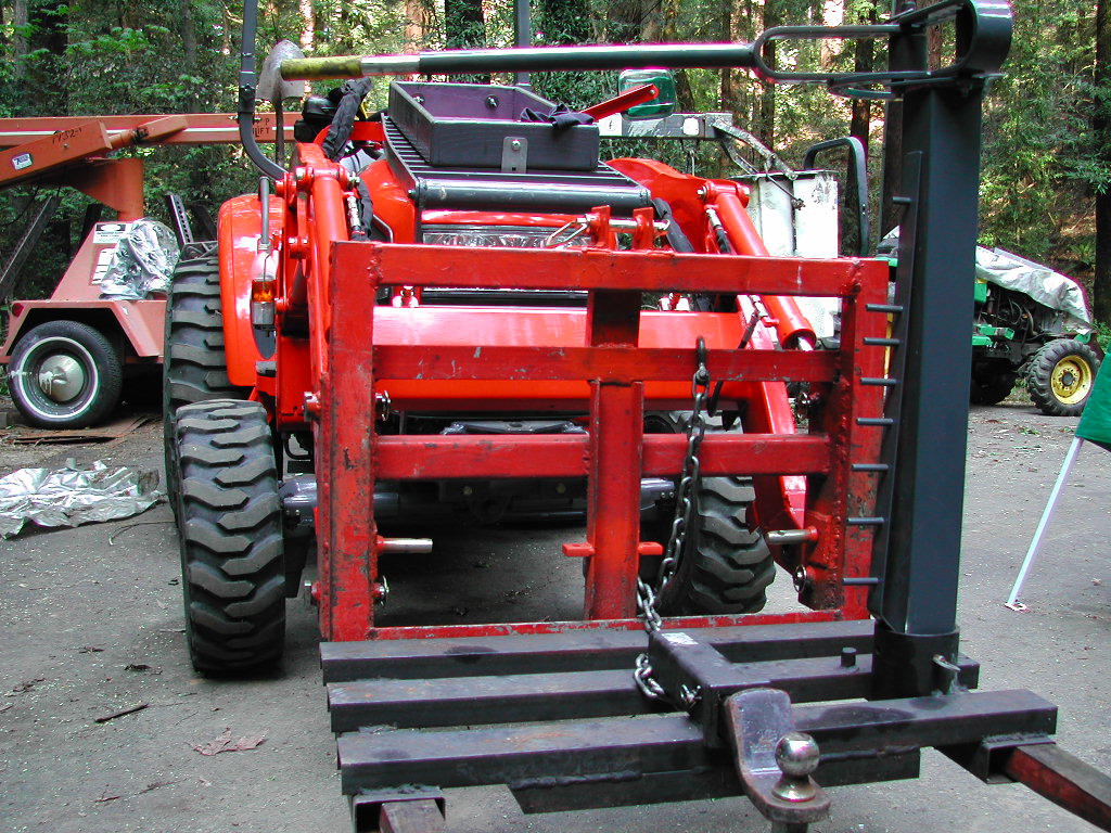

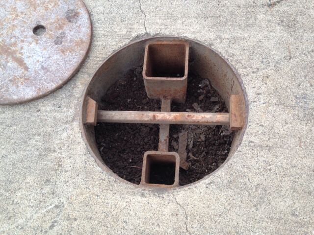

When I poured a new concrete pad in front of my shop I set in two receivers to accept 2 and 3 inch square tube. These come in handy for benders, tire changers temporary jig setups for fabrication or???????

Great idea... nicely done.

Great Idea Big Barn... I'm pouring a 40x50 slab and will be doing some of these... Thanks for posting...

When I poured a new concrete pad in front of my shop I set in two receivers to accept 2 and 3 inch square tube. These come in handy for benders, tire changers temporary jig setups for fabrication or??????? <img src="http://www.tractorbynet.com/forums/files/build-yourself/388416-locating-using-compact-bender-image-3155777043-jpg"/> Terry
Forgot to mention, but you prob already figured out-- the top cross bar is for an anchor point to attach chains for comealongs etc. :) Terry
Now that's thinking ahead. I like it.
