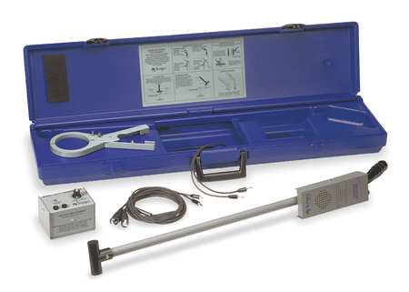

i use my trusty Greenlee 501. 1UG78_AS01.JPG It finds anything metallic up to 7 feet deep. VERY accurate depth and locator. Ive tested it in asphalt covered parking lot where I PUT in the wires 5' down. The found the wires and told me the depth to within a few inches.
Some electricians have this unit. You can call some from phone book. it sells for $700 - 800 bucks, so not for the homeowner. I have also found plastic poly pipe...but i had to fish a metal fishtape thru pipe first.
I actually found a cut wire inside a house. I hooked it up to one lead and followed the wire throught a 2 story house till i lost the signal. i opened the wall and found the culprit.
I charge only $75 to mark out someones place if im in the area..more if its a separate trip
to kentucky it would be spendy haha
call your local guys... someone has one of these
