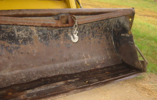

Those pics are from delivery day in February '03. After 140 hours of use, you can imagine that those hooks and that bucket 'aint so shiny anymore /forums/images/graemlins/ooo.gif

My loader came with 5 hooks- a pintle in the center, 1/2" chain hooks on side, 3/8" on ends topside. The pintle had a doubling plate, while others were welded to bucket and were trying to tear out. Cut the 3/8 and 1/2 off and installed 1/2 hooks with doubler on sides because I don't trust 3/8 chain with industrial euipment. The doubler plate will save your bucket.

I kind of like the bolt-on method of attaching a hook or slotted angle iron since it would make it easier for me to install and replace later as I am not a welder. My little bucket has a square tube running the entire length along the top, so it should be plenty strong.
Guess I should go with grade 8 bolts?
   / Location and attachment of FEL chain hooks? #36
<font color="blue"> "go with grade 8 bolts" </font>
That sure out to do it. I might also suggest that you put some steel plating inside your bucket so that you'll spread the stress out over a larger area.
Good luck with your project. I hope this helps. /forums/images/graemlins/smile.gif

I should't have to add any more steel plating due to the square reinforcing tube that is part of the top of the bucket. /forums/images/graemlins/cool.gif

Here's one of mine. The socket is for a round bale spear. In addition to the center hook, see the loop at the far right corner for hooking to the corner of the bucket. There is another one at the other corner.
Gabby
