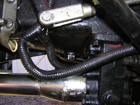

I found it . That is the area that I hit my head on at least once while trying to find the plug . I loosened it and I have gear oil in there. I will check the oil level in a day or two after the diesel dissipates. Thanks Robby

Hey Robby,
If it were mine, and if I weren't going to flush out the Transfer Gear. Then I would take the drain plug out and let the oil that is in it drain out and then let a little bit more drain through it for about a quart or so. That way, you will know that it is getting oil and the oil draining through, will help clean it also of residue.
Once the oil held in the Transfer gear empties out, you will only get a small little trickle of oil that will continue to drain, out the Transfer Gear Case. I think that the oil, getting to the Transfer Gear is also going through bearings, and that is why, that it is a good idea to flush that part as well.
Don't forget to flush your Front Drive also. You have 3 drains on the front End. One on the bottom side, of each steering wheel unit, and then one in the middle of the front drive, on the right hand side/Looking at the tractor from the rear. The drain bolts are, if I remember correctly, about 7mm and are square headed and easy to round off, if you don't have a tight fitting wrench.

   / Location of transmission drain plugs JM224 #16
Both of the front one's are pictured here. The obvious one will drain out most of the oil. The second is above the drive shaft about 4" in front of the drive housing.
