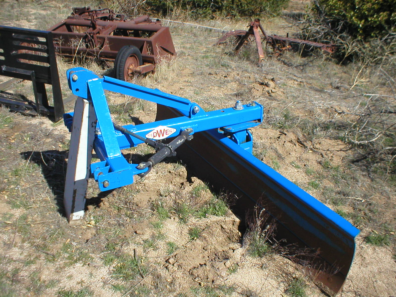

Here is a picture of my heavy duty rear blade and IMO, anything much less than what is in this link is at best medium duty.

Nice blade.:thumbsup:

It has been one of my best implements.:thumbsup: I went through the deal of the dealer telling me that the a (heavy duty medium duty) blade was all that I needed. And at 680lbs it worked fine, but it was not up to the constant large loads that my (at the time 10,000lb) tractor was able to put on it and it ultimately found itself having no curve to the moldboard as well as the moldboard ending up being bent backwards. :eek: I wish that I would have taken pictures of it, but once I bought this Land Pride unit, I never gave it another thought. ;)
The blade would have been an nice blade for a 50hp sized machine.

Is that a little scraper in the background ?

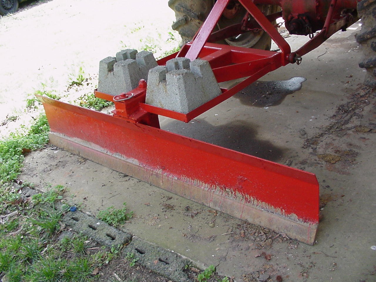

A couple of years ago when my center pin hole wallowed out on my scrape blade, after I repaired that, I welded an angle iron frame to hold 2 heavy concrete post blocks on my blade that was left over from another project. These can be removed when needed, but so far I've always kept them on there when using the blade. A little extra weight on this cheap 6 foot blade works for me so far. I thought I'd have to worry about them bouncing out, but never had that problem yet.
