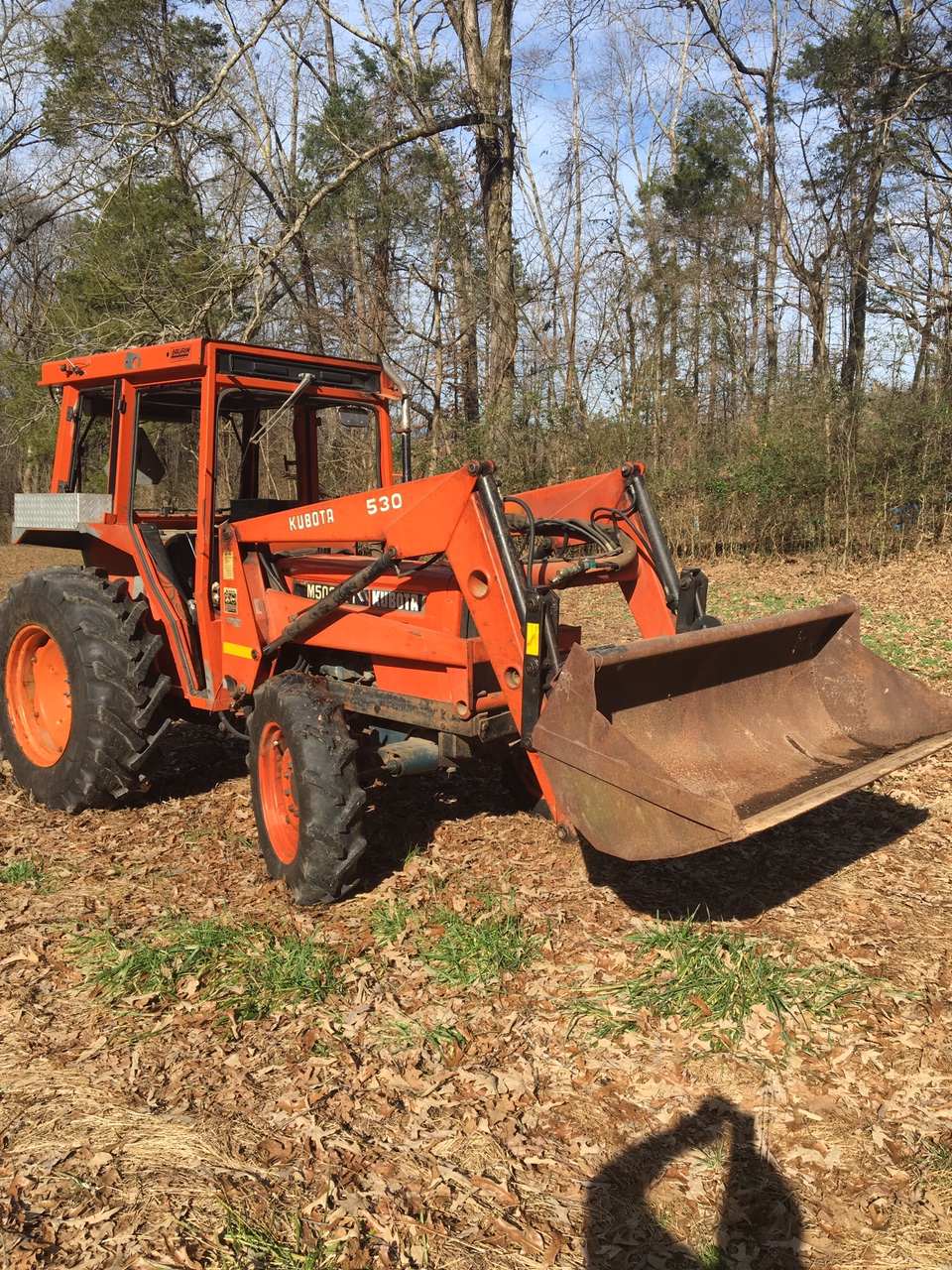

My M5030DT is built like a tank. Has front autolocking differential. With hilly East Tennessee makes a huge difference.
Hillside mowing, turning uphill and loader operations are greatly enhanced and unnoticed until you try the same with a tractor without it. L3800 and M59 don稚 have it. Not sure what tractors have the locking front diff now and didn稚 get much help from the dealer. Was hoping the M59 could replace the M5030. The older tractor is a real puller. I know tires make difference.

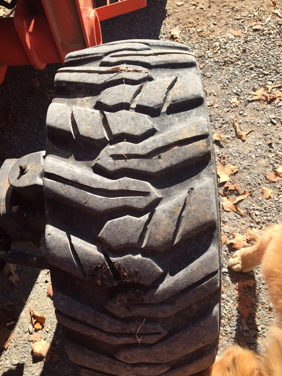

Grooving the front R4 tires of M59 helped traction.
Maybe I need to quit climbing mountains.

I’m no expert. The M5030DT doesn’t cut the ground in 4wd anymore than the L3800 or M59. It’s not like locking the rear differential. When turning up hill the tractor weight is basically on two wheels. No problem for the M5030. The other two tractors you spin opposite tires of the two axles and have to engage the rear differential lock. Guess I didn’t know how rare this is.
Had a front axle wheel gearcase leak and clicking sound from the front axle. Took it Kubota dealer. Mechanic used the loader to lift the axle off the ground. Rotated one wheel and the other wheel turned the same. “Buddy you got something major wrong”. I explained the locking differential and offered to go back and get the shop manual. They took it apart, replaced all seals and found no damage. Clicking was from low oil. $700 some of the seals are high. Wish my M59 had this feature.

Kubota manual calls these a NOSPIN front axle. Are there any newish Kubota tractors in the 40-70hp range with NOSPIN front axle? It gives remarkable improvement in traction. Enhanced loader operation.
