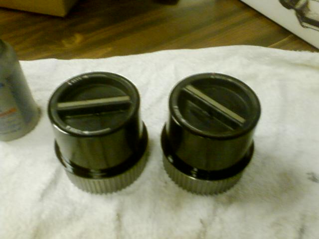

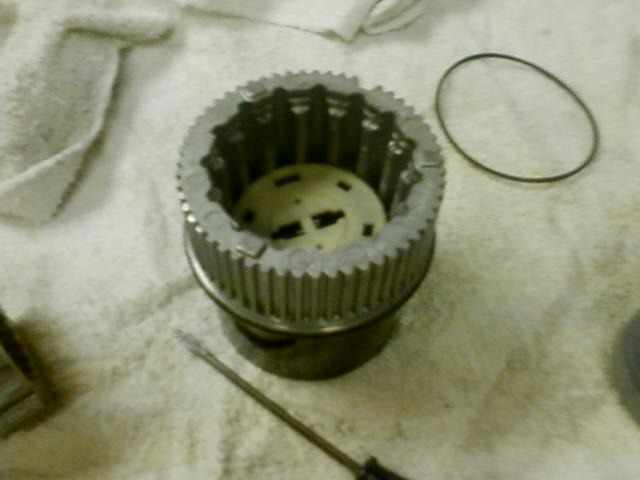

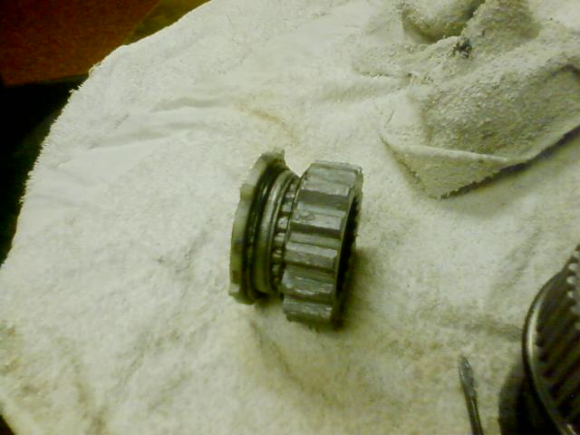

A few more pics for you.

I have the same year F-350 with manual hubs and I've had it with taking them apart, cleaning them, etc... Before the winter I need to replace the front hubs (as in everything behind the wheels), ball joints, and u-joints. The locking hubs are going in the trash and a new set of Warn hubs is going on. The plastic front hubs are the weakest link in an otherwise extremely well built truck-just get rid of them and be done with it :thumbsup:

I have a 2000 with the auto hubs that have a setting for "lock" or "auto". I've pulled the hubs out before and they are not serviceable to fix the tight dial just as the link to guzzle's procedure tells you. The Ford hubs are crap. If you want to fix this problem then pay the small money and replace with Warn Premiums. It's cheap really and the hub is better. You can't fix the problem you are having with maintenance, it's a flawed system. 150$ for nice, strong, new hubs is small money compared to the effort you'll expend on an attempted temporary fix.
