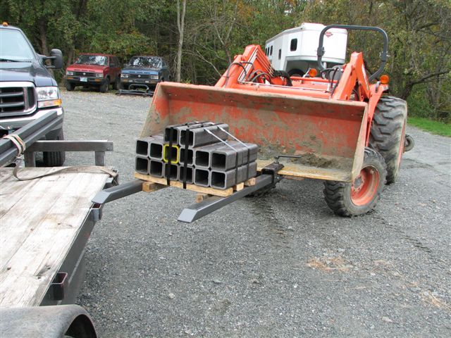

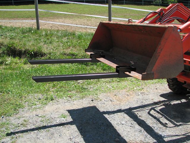

Heres a couple of pics of my homemade clamp on forks. I happen to have a cnc plasma system in my home shop....so fabricating forks is a breeze! The first couple of pics were of my first fork designs...the latest ones are much more robust.....and stay straight on the bucket better. I have used them a lot with the Kubota4310....lifting in the 1500lb + range....must have weight on the rear to do this!

Jim; those are nice looking forks. :thumbsup:
Consider also attaching some uprights to the back of the bucket to stop a log from rolling back onto your seat.:)
   / Log Forks #33
I have made a few sets with uprights......when I use them I just don't stack the logs any higher than the bucket! Fortunately my firewood is all done for this winter....

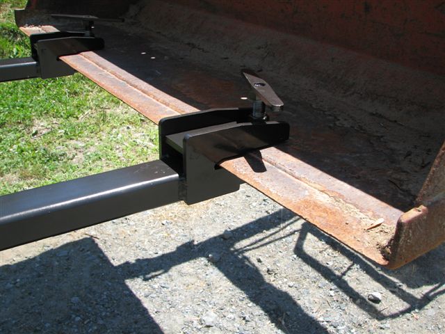

Starting the quick-release frame:
End uprights going on:
Test fitting:
Frame complete, primer on:
Building up reinforced fork tang:
Fitting tang to socket:
Building up the fork tine:
Tang and socket, drilled and ready:
Attaching the sockets:

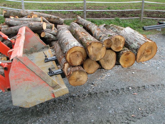

Now we're loggin'!
Bucked logs, ready to split:

I believe I can safely say your work looks like"factory"!:thumbsup: Pride of workmanship is showing through! I'd encourage you to give yourself a pat on the back but knowing better, I'll just mean it figuratively.:):thumbsup:

Thanks. It did come out okay. Better yet, the bucking went really well. I'm so late on my wood this year and that is what this has all been about.

Nice forks! That frame looks really wide, which should make handling long stuff a lot more stable than with the usual width forks. I take it you've recovered from the creeping crud? Just in time to cut wood - hope the weather holds out.

Now you just need to add a hydraulic clamping arm and you can carry those logs around wherever you want. Great for brush, too!
Nice work, planning and welds. Easy to tell now your self-criticism was banter.
