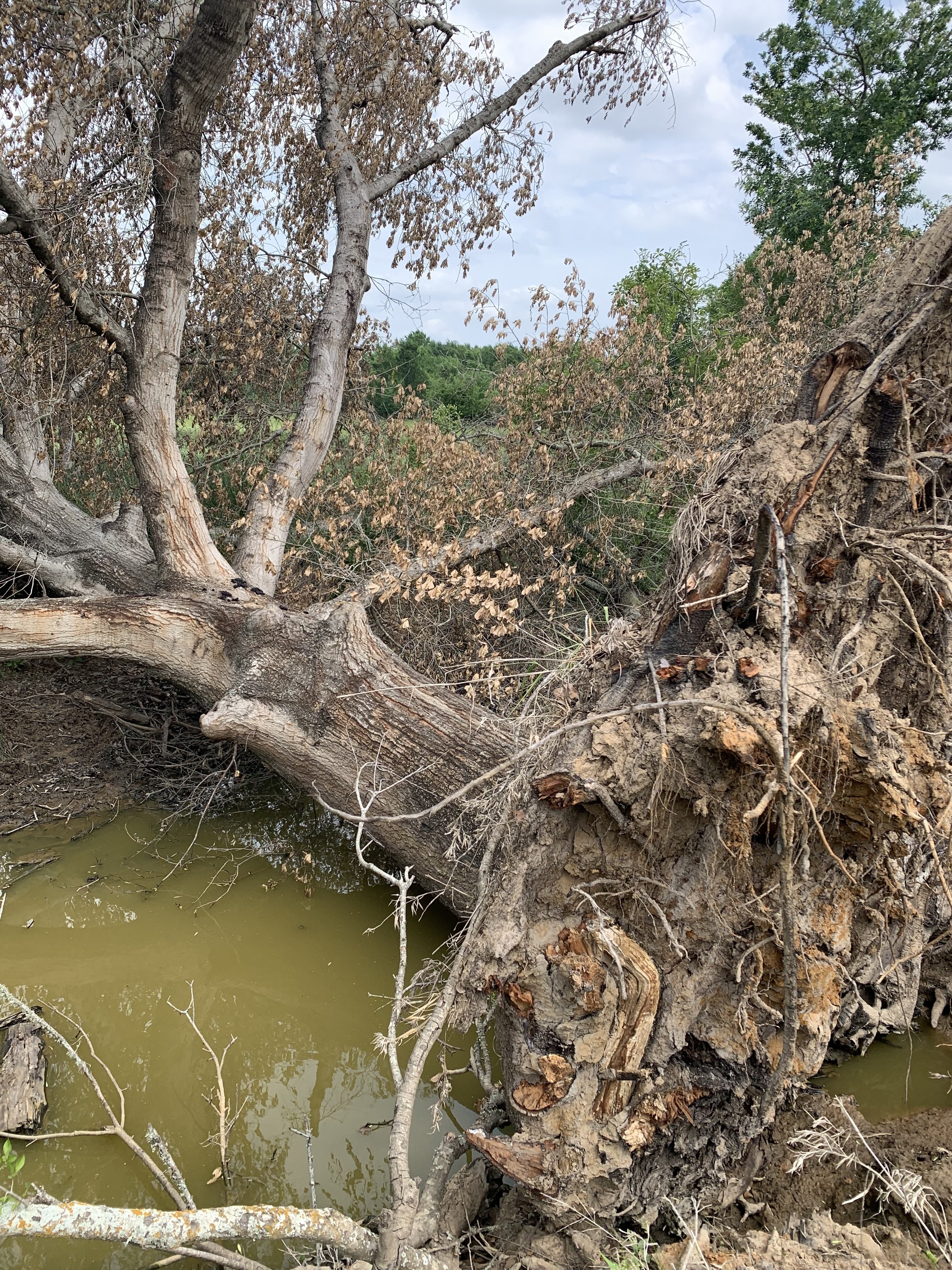

That is a good and heavy stick. Use your drawbar a good cable or chain. If you want to minimize ground damage hang a block in a tree to give lift, run your line through the block.

I moved a large dead oak (trimmed) yesterday, out of the forest to use as a drainage break/border. It was around 12” diameter and 22’ long; solid.
I attached a chain around trunk, then to my tow strap to draw bar. I had about 40 ft of chain/strap to clear the forest/thick brush.
I then used the grapple and was able to lift the entire log, whole, and swing it/lift it in place. All went well with zero issues. That grapple is worth every penny!
