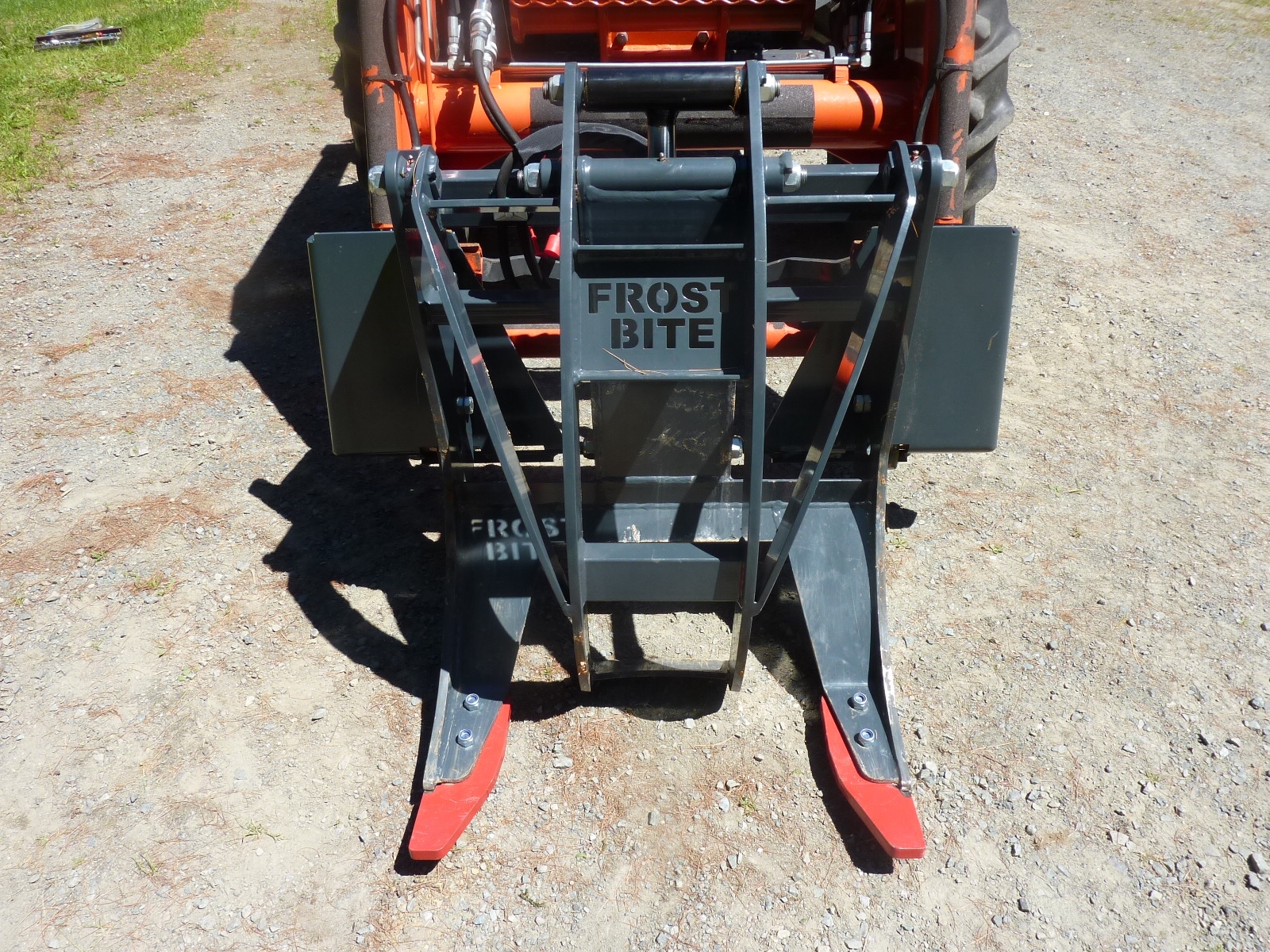

Did the shopping, ordered a Frost Bite GR-2o, put it together and it is looking good.
I see the holes where teeth would bolt up, wondering if teeth are needed.
As a low volume user, not likely the lower jaw would wear enough to justify, any opinions?

OK - so I had to look at the FB web site. Good looking - strong grapple. My Land Pride grapple has teeth - right out on the last 6" of each shank. Both top & bottom lids.
To be honest - I have no idea if they help or not. I would - go ahead - use it as you got it. You will then determine if teeth are necessary or not. My guess - they are NOT really necessary.
You clamp down on any object - tight enough to keep it within the jaws - it's not going anywhere.

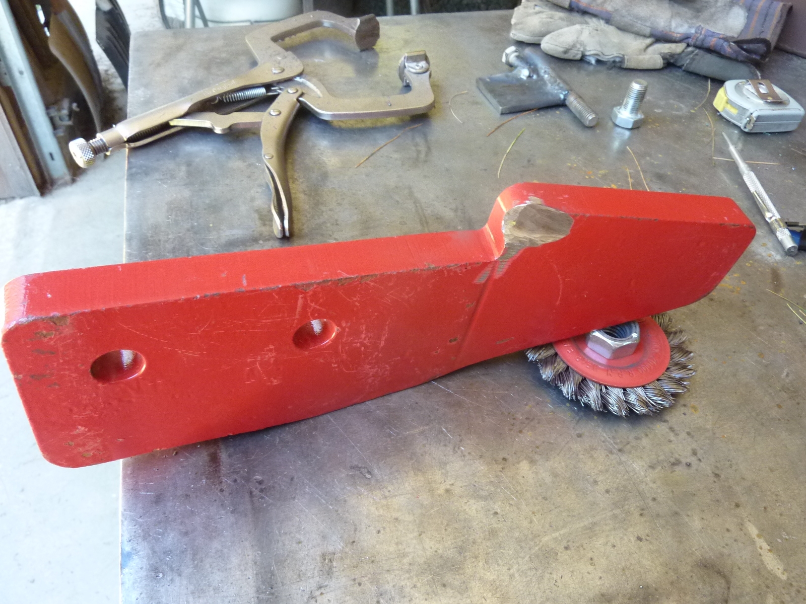

The holes are for add-on optional extension tips. But no reason you couldn't teeth in there. Not really needed though. It is a great log grapple.
I bought my extensions from Sundown made for a GR40 grapple. Had to grind them a little.

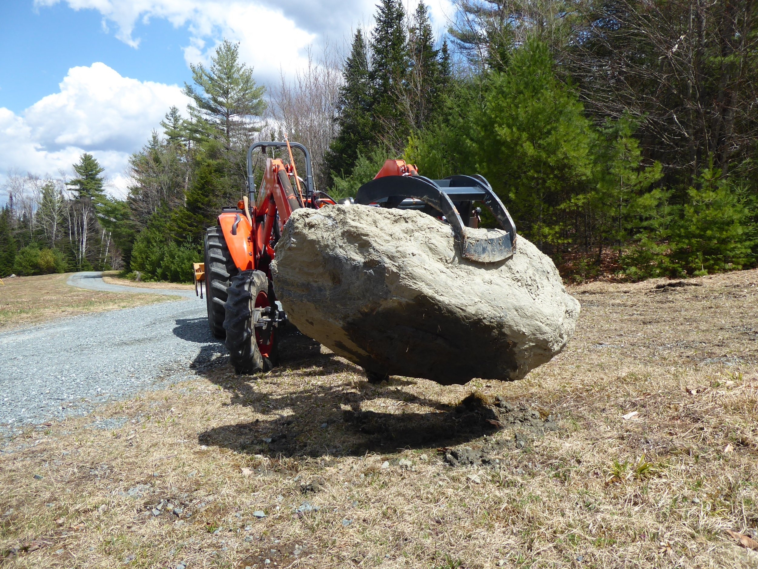

That Frost Bite grapple would work just great on the rocks I move around.

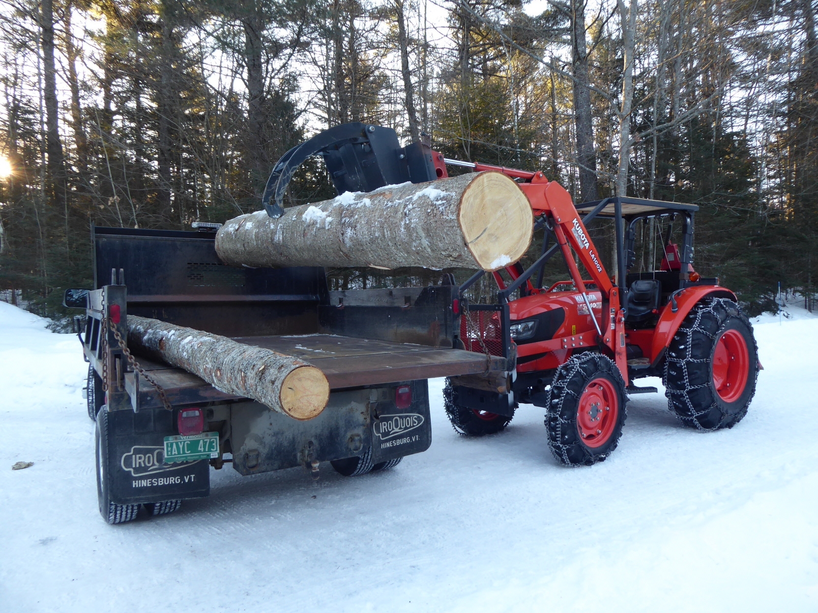

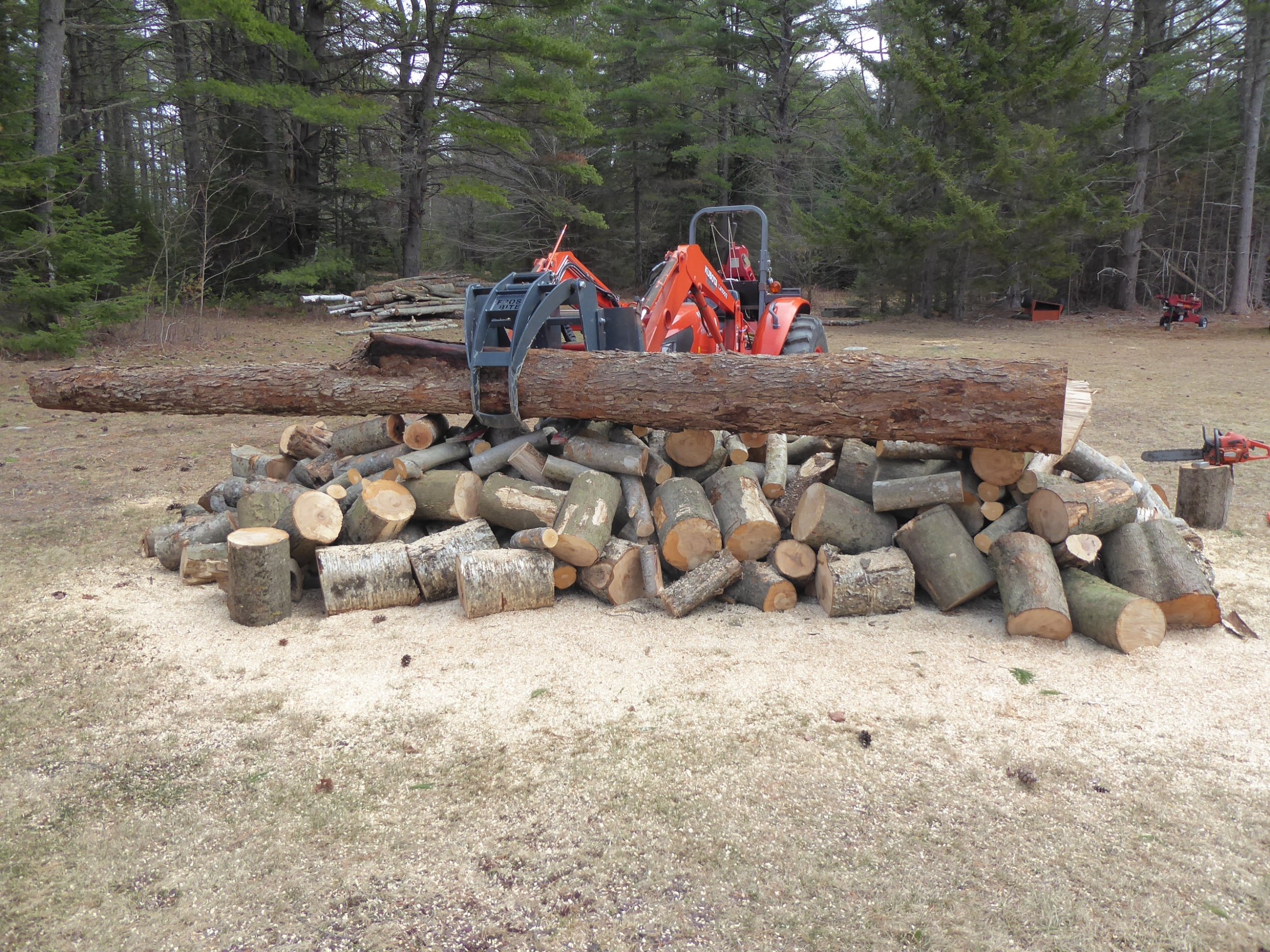

Nice lookin logs GG. Straighter than a paralam.
