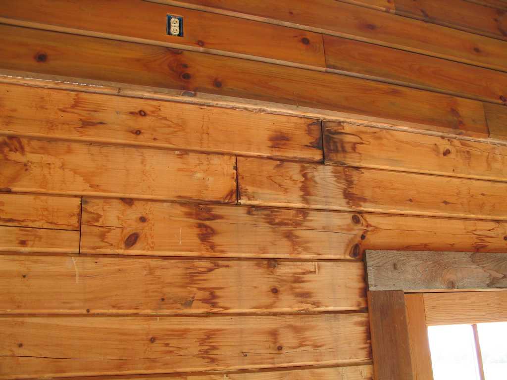

If the staining of these house logs was on the outside, I would tend to think 'no major problem'. But, these stains are pretty clearly from water coming in from the outside, and all the way through the log joints to the inside. This means that the water is and has been between the log joints. Much more serious to me than just some superficial staining. To me this is all the way through the logs at the corners and as well, around the windows and down through the walls. One can choose to ignore the signs that are evident, and some probing should be done to make final determinations of soundness of wood.
Clearly a poor design for log (which is easy to do, IMO) construction.

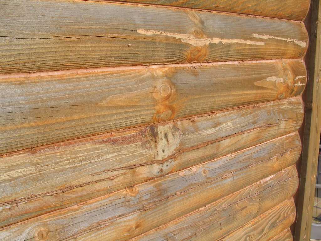

I visited again today and got some more pictures. This first one is a look at the outside logs and the somewhat amateur chinking / calking job.

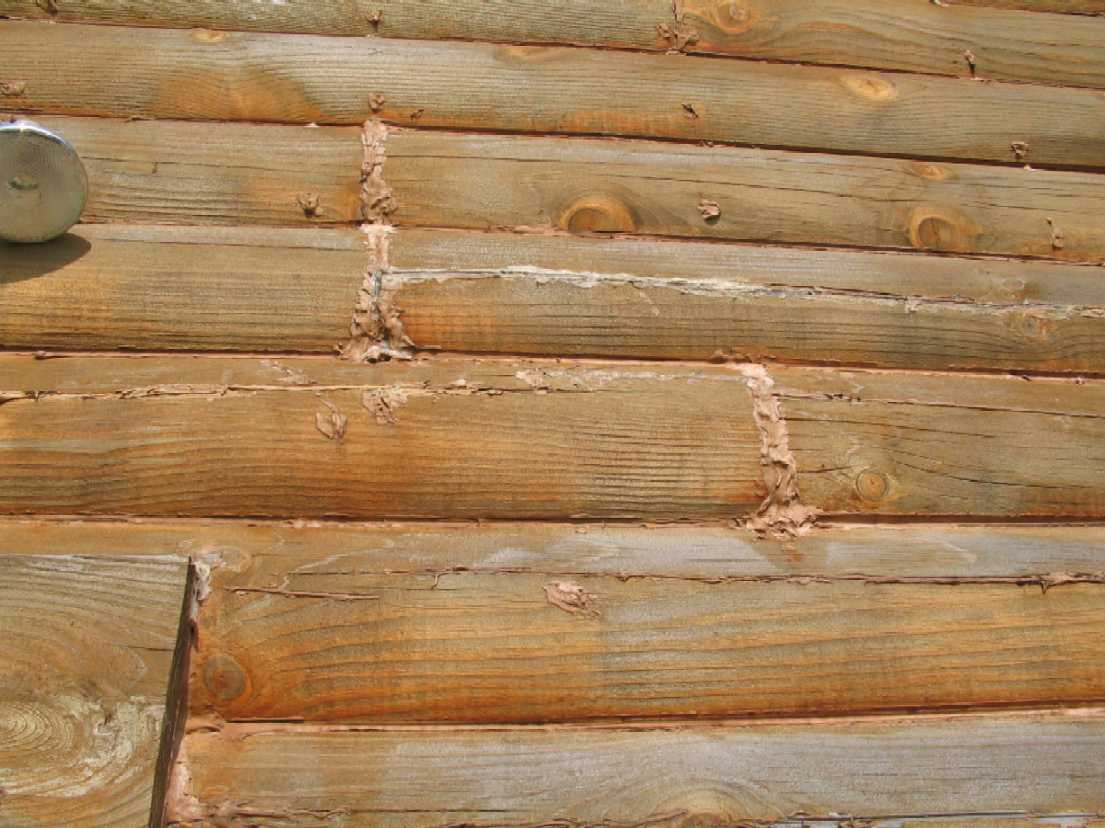

Another view of a side wall.

Some of the damage. This is the inside portion of the first picture above. Notice also the log "siding" above that shows no damage. Of course, I'm sure it's there, just not visible. Half of the house interior has the log siding material and so the damage isn't visible. One option, after fully fixing the leakage, is to use that material to "repair" the inside. Could also use the bleaching, staining method mentioned by Marty.

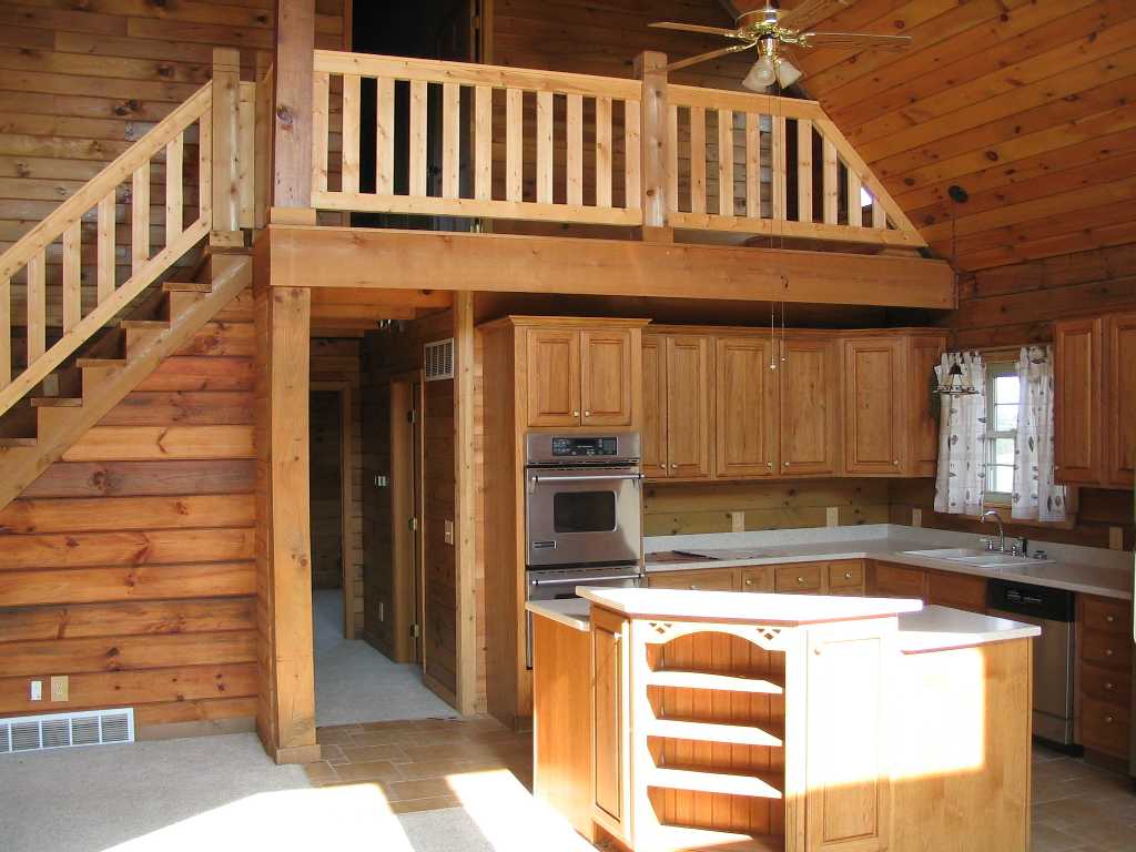

Just to show that there is some nice aspects of this home. Here's a view of the open kitchen.

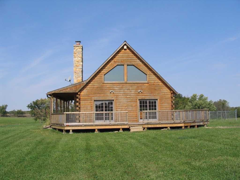

And a view of the south side with deck.

That's not chink it's caulk. Chink is a latex based motar that is designed to expand and contract as the logs will do naturally. Caulk on the other hand is not really designed for this application. This may be partly the reason why your seeing water damage. This caulk will not expand as far as the chink will and the result will be voids between the logs which will let water and other things can get in. Having said that, and as bad as some of these pictures look, I think you can still work with this provided that the damage (ie.. rot, pests) is not inside the walls. A lot of work to correct, but maybe worth it. Proceed with caution. Hope this helps.
   / Log Home Owners? #28
I agree with RTVman, he obviously knows his RTV when he sees it. /forums/images/graemlins/grin.gif /forums/images/graemlins/grin.gif This is terribly amateur work, and would need to be removed and re-done right but if the logs are intact, its just some painstaking work. My wife and I filled all the cracks on our exterior surface, I think it took us 2 or 3 weekend and was a pain /forums/images/graemlins/mad.gif. I wish I had a picture handy of my house going up. I stopped at the start of the peak on one side while I did other work and the other peak. I then put that peak up 3 weeks later in one day, I have a picture somewhere. Night and day difference what 3 weeks of sun and rain will do to un-protected pine. Even worse to imagine what 5+ years of neglect can look like at this place, but again if the wood is not damaged down deep, you can recover from this. If you end up going with it, it is important to remove the surface decay either with mechanical means and or bleaching/scrubbing and I would recommend a borate wash after that and think about mixing an insecticide into your outside finish to insure you don't have insect troubles. You may want to find a place that would corn cob it and re-finish it, get their rough estimate and factor that inot any offer you would make, assuming you can ascertain that the basic wood is still OK.

I've got another question. I went back to your pictures, but I'm having a hard time with one detail. Does every log have a chink line? Some of the log designs had a little space like 1/2 by 1/2" at every outside joint which was supposed to be chinked. It was as much for looks as anything else. One joint in a picture looked like that style, thats why I'm asking, or was that just more owner-caulk-happy work?
   / Log Home Owners?
#30
Yes, there's no doubt this was an amateur job and the house has had to endure for many years in this condition. Marty, I'll add some additional pictures to see if you can get your answer. It looks to me like every log had the caulk in it. Most of the knot holes and cracks were also caulked.
