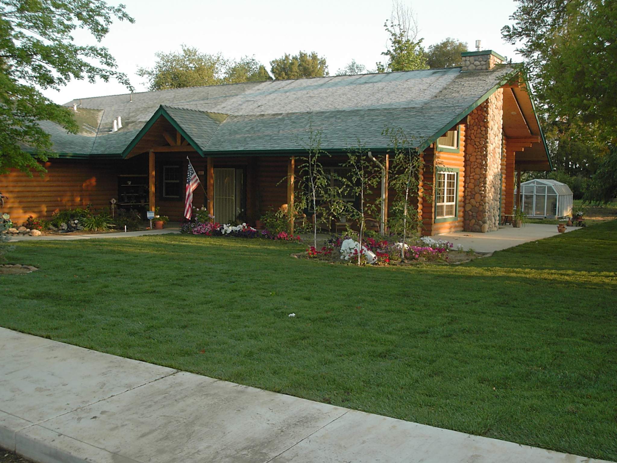

Using the pressure washer to remove the mildew is pretty much a waste of time. It isn't going to come out. I had that done when I first built my log house 30 years ago and it didn't work. My house is made of white pine. The best wood preservative is Cuprinol bar none. I bought a 55 gallon drum of it and used it until it ran out and because of the mildew stains I use a slightly dark redwood stain periodically. I really hated to stain it, I wanted it to be a natural wood color, but the midlew stains sort of forced my hand. How those occurred is an unpleasant story of shipping snafus and lawsuits.
Here is a picture I took a couple of years ago:
