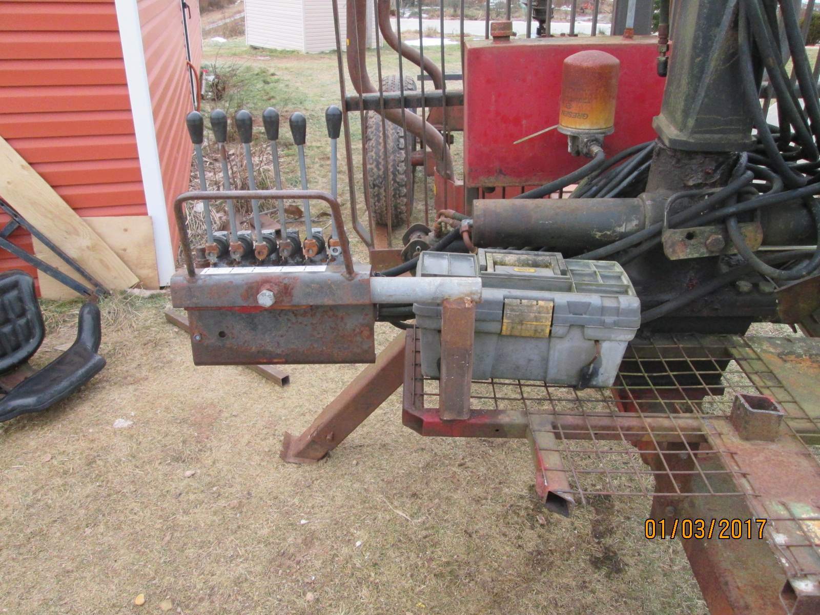

My guess is that you need to extend the tongue. It looks like the front of the trailer will hit the tractor tires.
A side view picture would help.
How wide is this?
Plan was to remove some of the deck

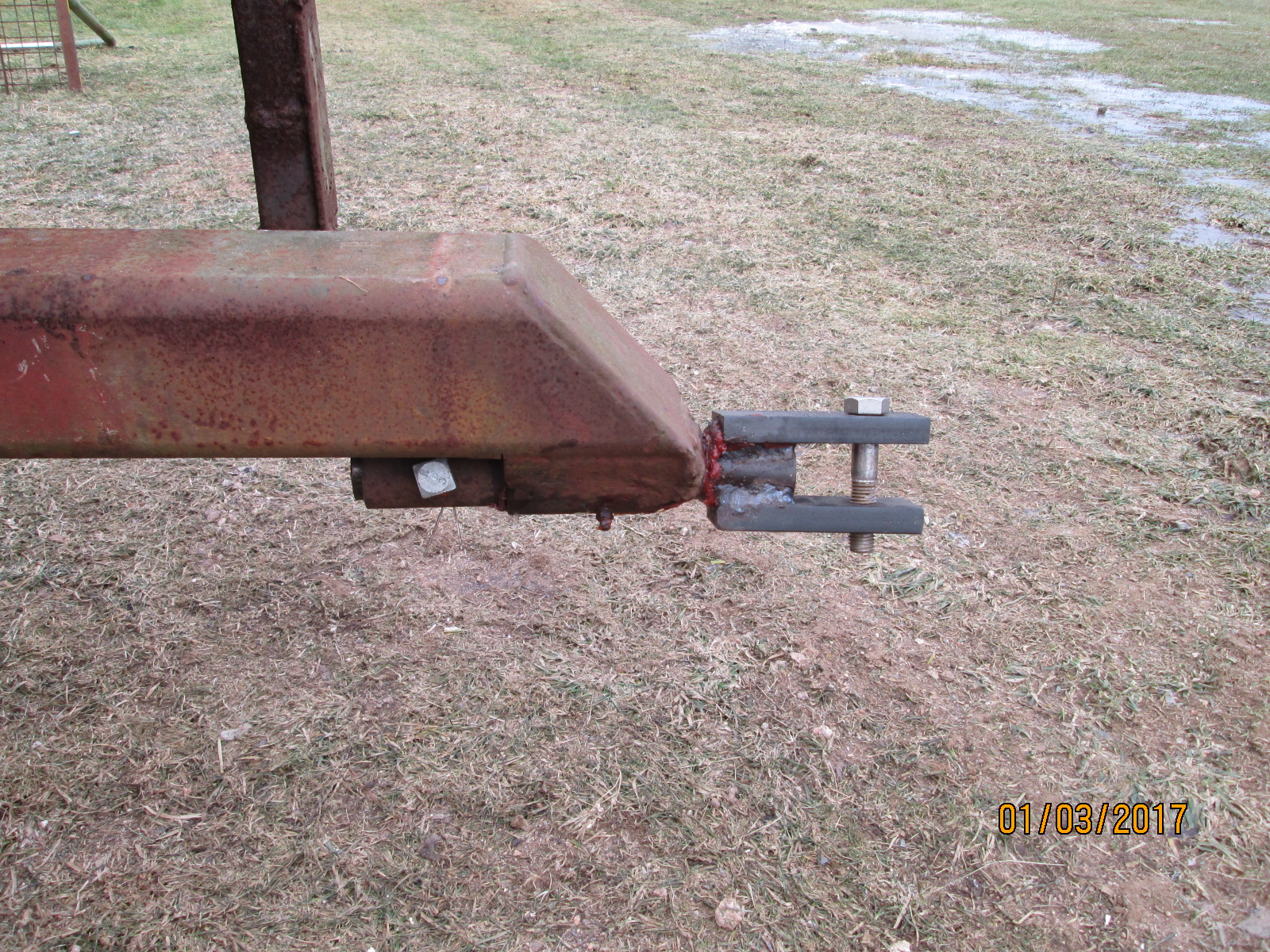

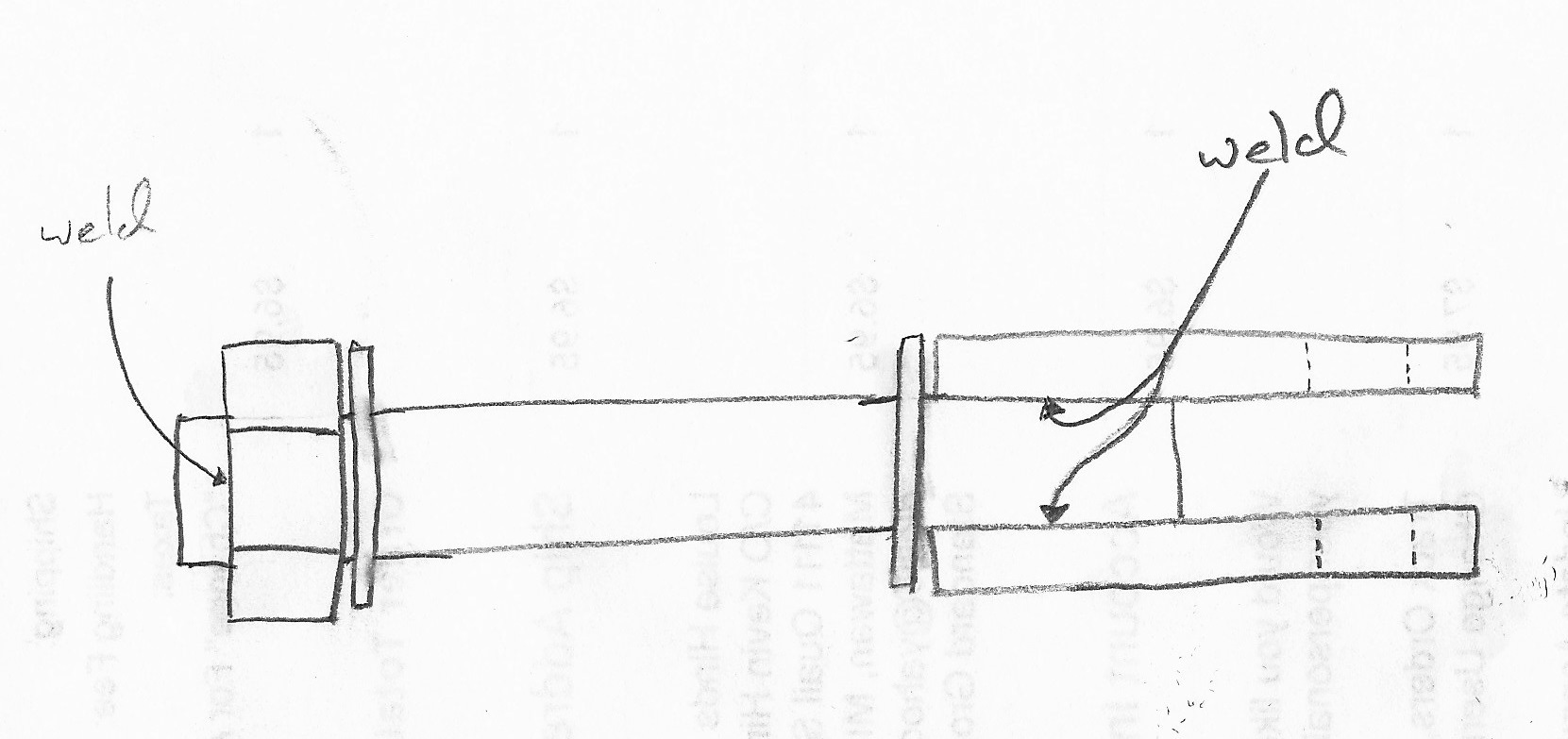

Looking at the online pics, which aren't very good, it appears it's intended to use a pintle hitch, with the ring mounted in that round hole that's empty... If that hole is is at a proper height to match your tractor's hitch, you could make a clevis style hitch for it.
I'd suggest using some 1.5" Cold Rolled Round for the through-tongue part. And use 5/8" x 2" Cold Rolled Flat for the upper and lower parts of the clevis. (1/2" A36 plate will probably not break, but the holes will elongate quite rapidly.) If you can't find cold rolled flat in 5/8", then go with hot rolled in 3/4" thickness. (Hot rolled is softer, but the added thickness will slow any wear.
Assuming this is a permanent mod, Just buy a nut (1-5/8"?) and two washers that will slide over the round stock. Put one washer at the front, as a bearing surface between the trailer frame and back of the clevis, and one at the back, then slide the nut on and weld behind it... Done. (I assume there's a grease fitting there somewhere, so if not, I'd drill a hole and tap one in, just to be able to grease it occasionally...)
Here's a nice picture I scribbled for you:

If you're trying to make a HD hitch from LD materials so you can weld them yourself, it's probably not going to hold up long... Build it from materials that will hold up, tack it all together with the welder you have, and give someone with a big welder $20 to weld it solidly. And if you have a welder that can do the 1/2" plate you were talking about, you can weld 5/8"... Just preheat it with a torch to get better penetration... Same for welding on the nut... Even a propane torch will work if you have a bit of patience... You're only looking for 4-500 deg.

Another option would be to take a bolt (such as this one ), cut the head off, weld your 3/4" flat stock to it and put a castle nut on it (yes, you may need a bigger welder, a $75 220V AC welder from Craigslist with $10 worth of rods should be plenty to do this).

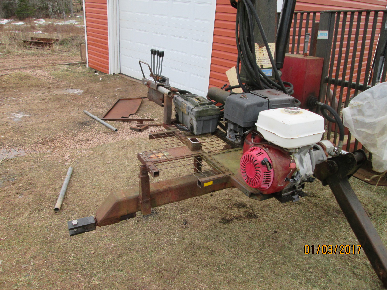

So this what I ended up with.
Had to angle the deck as it did hit the inside of tires on only a slight corner.
Lowered the control bank to ground level.
   / Log loader trailer swivel clevis hitch. #19
That should work. Are you going to put something across the front at an angle to support the edges of the wire mesh deck?
Aaron Z
