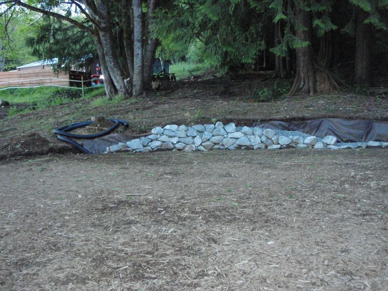

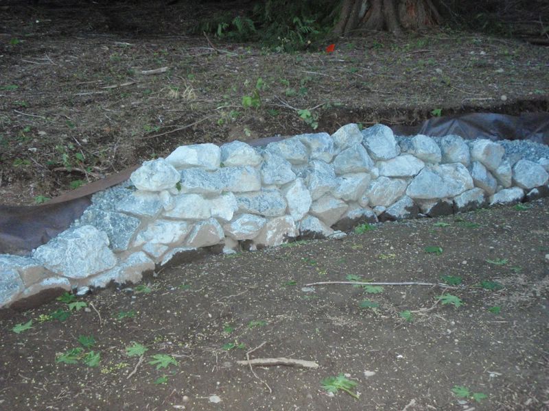

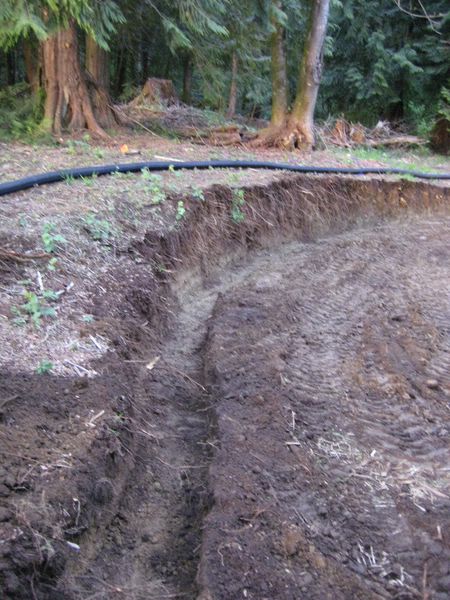

well here is the beginning stages - the wall is cut back and the trench is dug for the perfpipe which will drain into the swale. i have a load of washed 1-1/4" being delivered this morning so a few trips to the quarry should get me started - will post more pics as things progress - not much to look at right now..

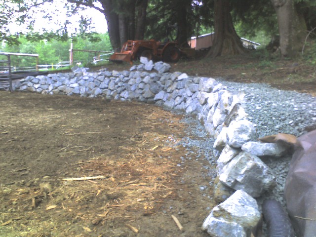

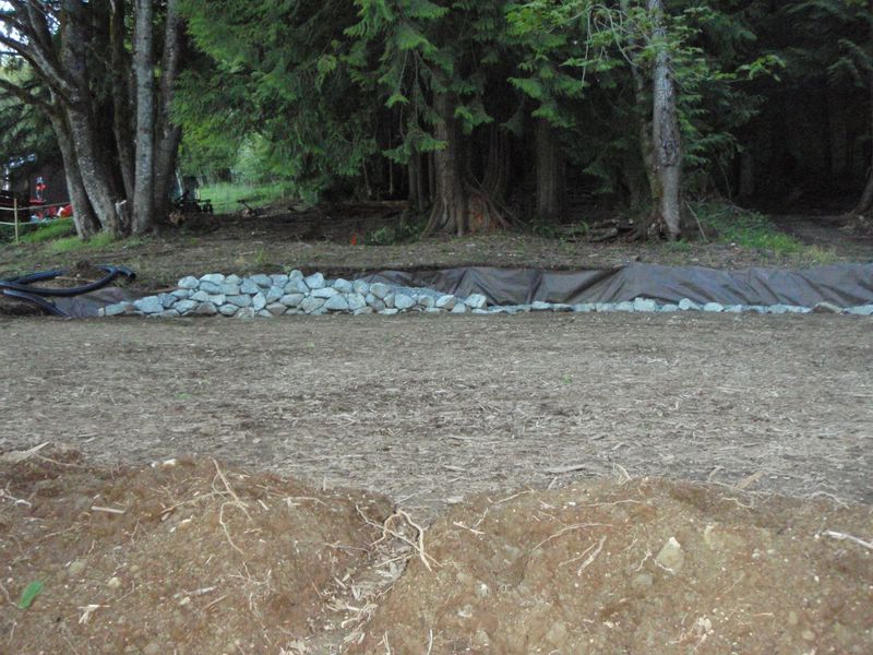

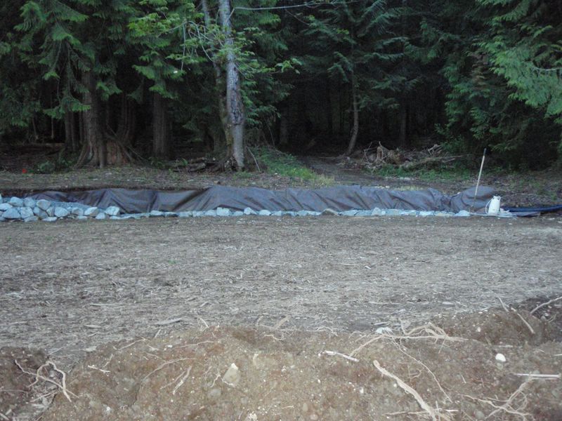

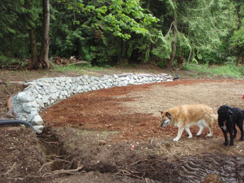

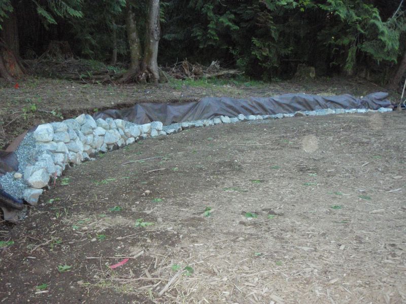

update on the progress of this wall, it's mostly completed now, 7 ton of rock and about 5 yards of 1 1/4 washed rock behind it.. i didn't have time to get my backhoe on the tractor this weekend so i still need to finish extending the outlets to the swale. we had a good soaker last weekend and it was pushing water out both ends of the pipe so looks like it's going to do the trick..

That's a beautiful wall you are building. I like the curve and the battered face. The curve and angle compliment each other nicely. This was a much better choice than the alder logs! It will be appreciated for decades, long after several alder walls would have rotted.
For others doing such projects and using corrugated perf pipes. Take care to grade your bedding layer of gravel as close to flat as possible. Forensic engineers here have found a large number of failures due to dips in the pipe. This aspect is of much less concern for a dry laid rock wall like bigballer's but becomes critical in an impermeable wall installation. Most civil engineers I have dealt with in the past ten years have ceased specifying corrugated perf all together and have gone back to rigid perf or slotted pipes. In critical areas like basement foundations it is also a good practice to place a layer of filter fabric between the earth cut and the gravel. We normally run the gravel up to 18"-24" below grade, run the filter fabric over the top of the gravel, then compact a moisture conditioned soil cap above the gravel. The higher the clay content of the cap the better. The fabric keeps the gravel clean and the cap keeps the subdrain system from being over charged with surface runoff which should be led away from the building at at least 1/4in/ft.
For corrugated perf I'd use a tool similar to a long concrete float but hinged longitudinally to flatten the bed before pipe installation.
Another practice that that used to be common and is now frowned upon is the wrapping the perf pipe itself in filter fabric. We used to call these "Burritos". These drains have a high rate of failure due to the fines clogging the perf holes relatively quickly.

Eddie,
French drains should get the same attention as retaining wall and foundation drains for the best results. But a french drain failure rarely carries the same implications as a leak directly into the basement from built up hydrostatic pressure and a clogged foundation drain. None-the-less, rigid pipe is better than flex pipe if you can spring for the extra bucks. If you still want to use flex, fine, just pay special attention to preparing the bed flat. And I wouldn't use a burrito wrap on ANY perf drain pipe anymore.
