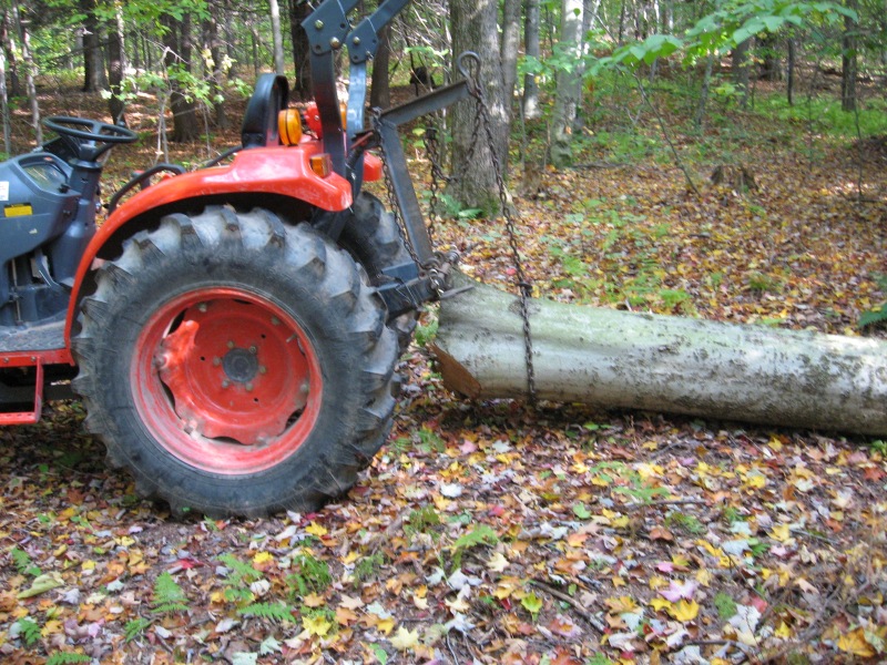

Any pull force applied to an object that might become immoveable(log hangs up on stump/root/rock) should always be from below the rear axle.
I have not had good luck with tongs and dragging. They like to pull straight. my pulls usually involve turns and negotiating other trees on trails. Using tongs, the log rolls around and the tongs frequently work loose.

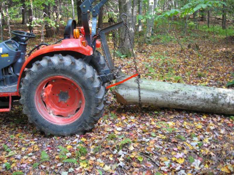

I use a boom like mentioned to lift the log a bit to get chains on and off, and also to lift the front end over obstacles when dragging(see attached pic shown in lift position), but the pull force comes from well down below the axle on the drawbar assembly, and the boom is normally lowered to allow slack for turns without putting any side load on the boom. I also very rarely have a chain come loose from the log when dragging. The tongs might be handy for lifting, and I havn't tried that, but I don't think they would stay on very well during the drag if left slack.
Rinsing the log with hose or bucket also helps a lot with chain/bar wear. I use a "peevey"(log roler bar that has 1/2 of a log tong on it) to roll the log up on something to get it clear of the ground. I am usually harder on the chains from accidently hitting the ground then from debris left in the bark from dragging.

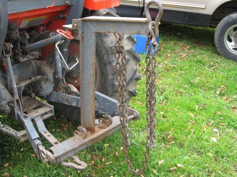

It's almost enough of a safety concern to look for a 3-pt log skidding winch. I've seen some real nice ones, but I don't expect to do enough of that kind of work to be cost effective. Incidentally, my NH dealer says he simply chains the log to the lift arms.
   / Log Skidding Tongs? #18

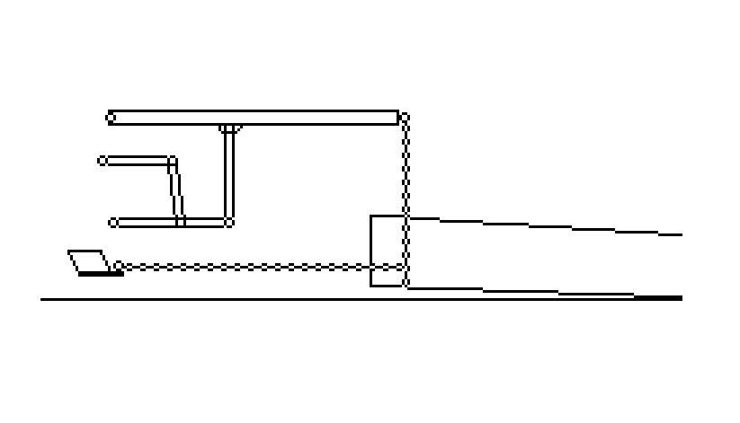

flIntlock; you can build something like this, It lifts the log off the ground just a bit and still keeps the center of gravity at drawbar level. The downside of the log will still drag on the ground, but it can still be cut without getting a lot of dirt on the sawblade.

   / Log Skidding Tongs? #20
Pretty neat piece of equipment. Not sure that it addresses the center of gravity issue and risk of rollover, though.
