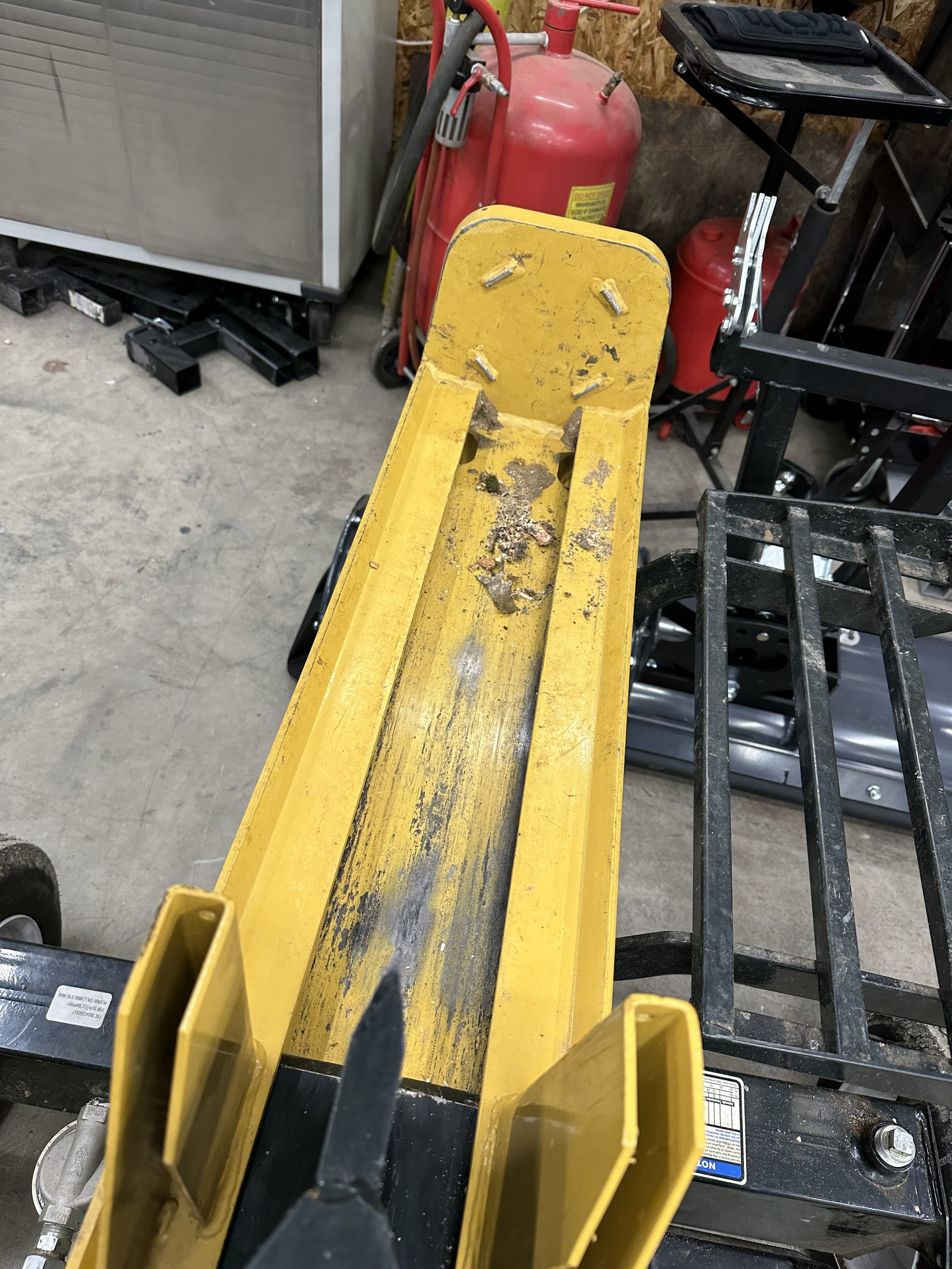

Thank you, everyone, for your thoughts and prayers. As for my father's age, he was 90, so he had a great long life and was a Korean War vet.
I took a break from everything else and walked over to the shop to snap a photo of the beam and wedge, as requested. Perhaps the flat end may need some more aggressive rough edges to help keep the wood from slipping.

   / Log splitter and a flying log - safety #102
Yep on more traction for your anvil. If the log wasnt cut off squarely, one of the split segments may not even be touching its anvil lug.

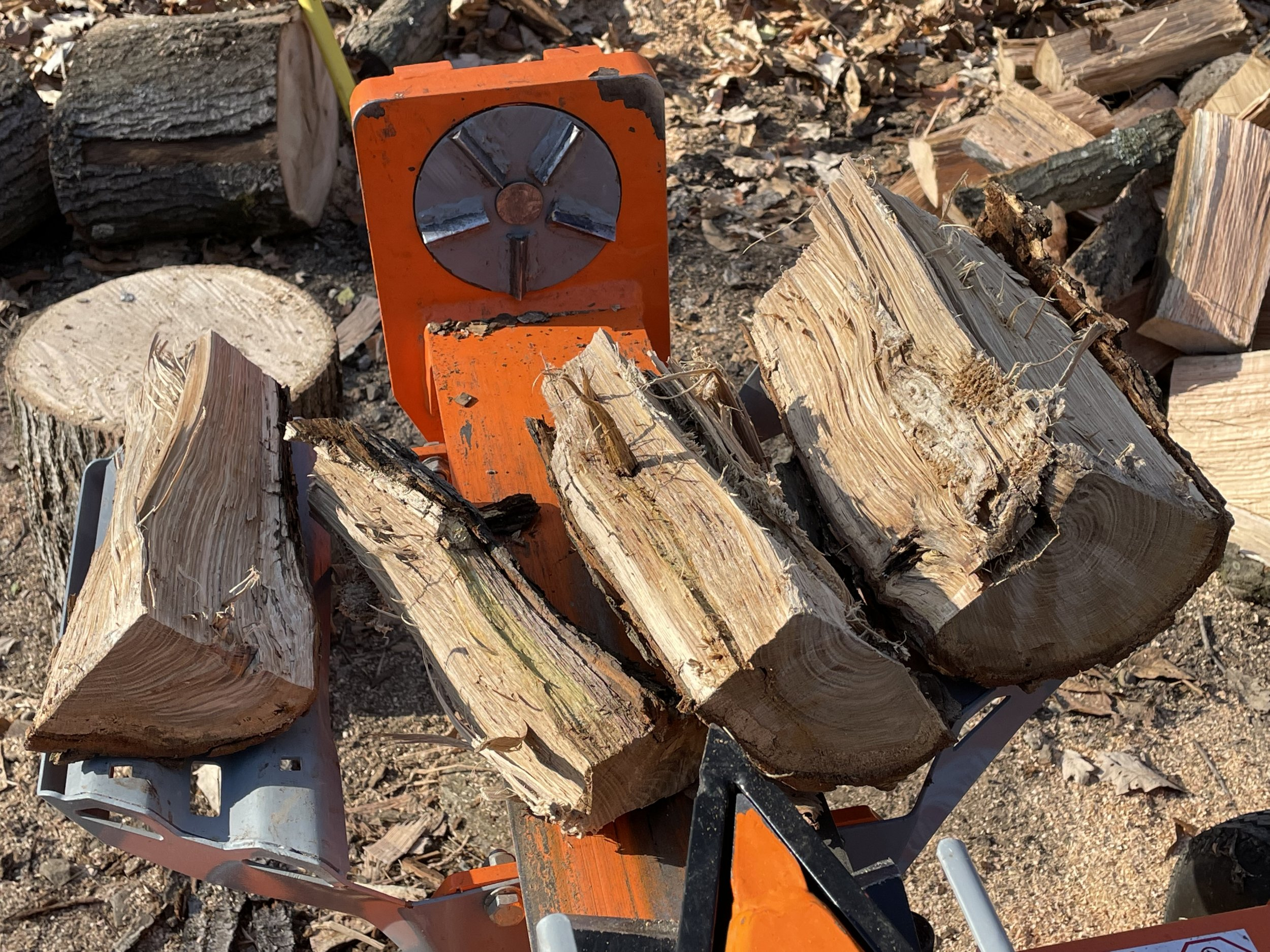

   / Log splitter and a flying log - safety #103
I have no idea if this is a positive thing or negative for keeping splits from flying. On mine the round silver thing on the bottom plate spins. I could see that helping to relieve stress, I could also see it allowing things to pivot and aim at you.

#104
That is interesting; I never saw one that rotates. I like the little wedges and should grip the log better.
