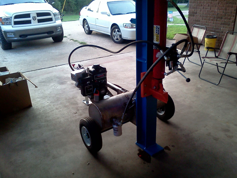

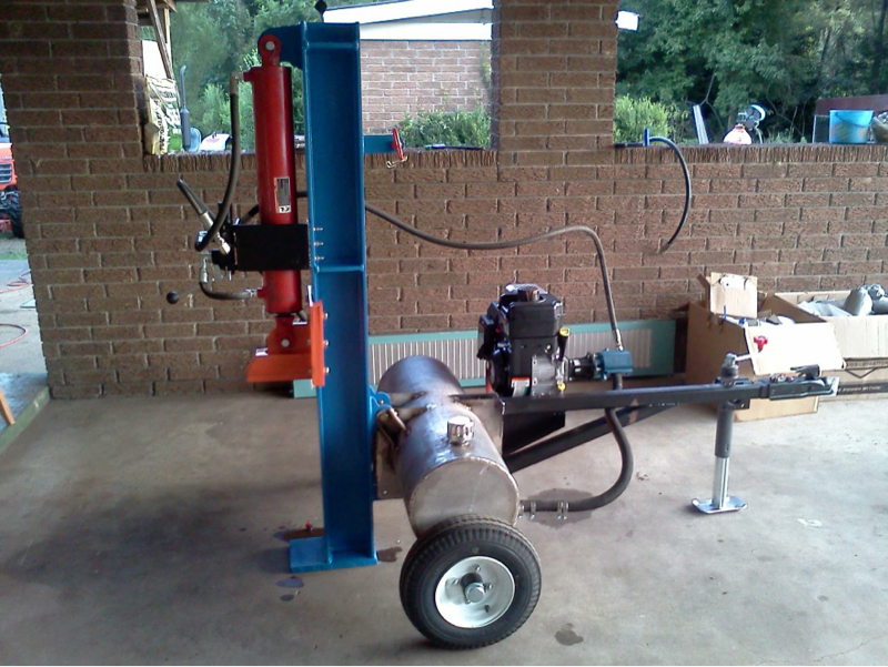

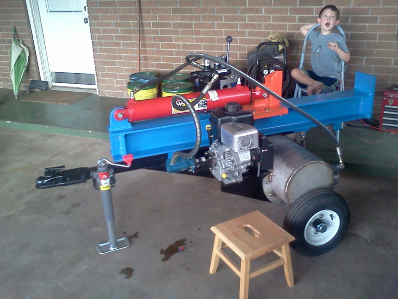

Got the splitter fully assembled. Had an issue with the pump mounting bracket. Mabe next weekend I can crack some wood! All it needs is a bracket 1" longer, and oil/gas in the motor, and hydro oil in the tank and she will be ready to go!
thanks

Nice looking unit ,maybe consider some protection for tank filter from wood falling on it.:thumbsup: Plenty of tank volume to keep it cool,most store bought splitters ,some homemades when worked real hard get way too hot.been there myself,modified,upgraded tanks to be able to be worked all day in all sorts of temps.:2cents:
   / Log splitter build #17
Are you planning to build a cradle and mount it on the i-beam? Very great work!
