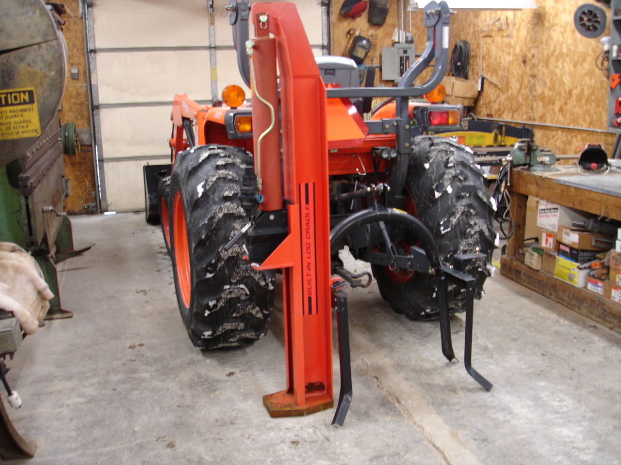

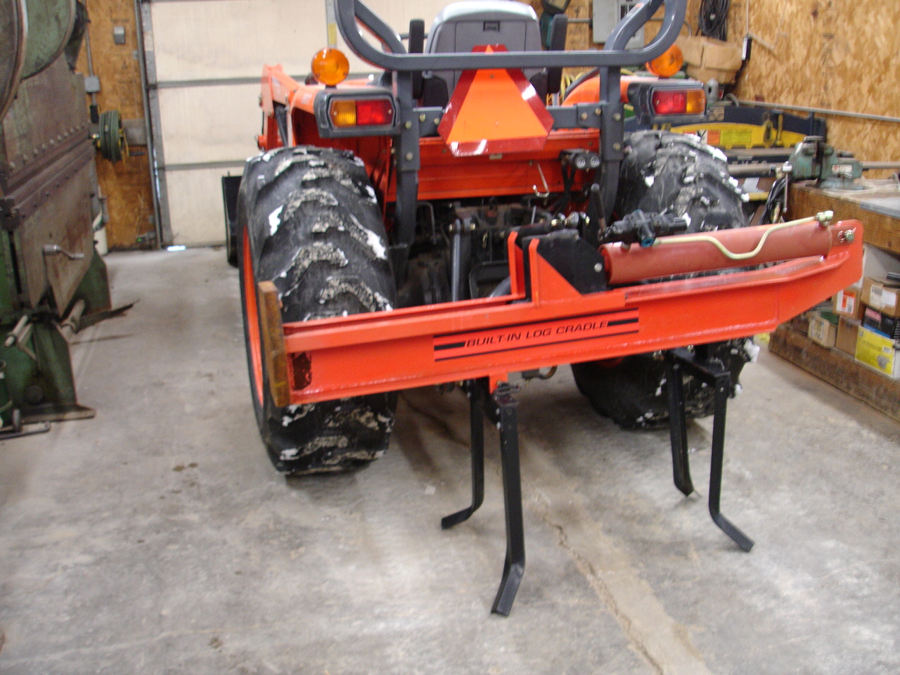

I have found two tractor powered splitters locally -- the Speeco at TSC and a Swisher unit at Rural King. They both run 4 x 24 cylinders, both operate either horizontally or vertically. The Speeco is 6 feet long, the Swisher 80 inches. The only major differences seem to be in the 3 point attachment method, the stand, and the fact that the Swisher can rotate 90 degrees on the vertical axis while in the vertical position so you can stand either behind the tractor or sort of next to it. Neither one looks like it can stand alone while working, which is something I would like since I have remotes on both front and rear of the tractor and would like to use the loader to move big pieces to the splitter, then hook it up and split them right next to the bucket.
The Swisher is made in USA, I don't know about the Speeco. Swisher makes a lot of trail mowers and such. I never heard of Speeco until I started looking at splitters. The Speeco is $700 and in stock while the Swisher is $600, but I can't see one since they don't stock them but will happily order one for me -- 3 to 4 weeks wait time after order.
I don't need the thing right away, so I have plenty of time to shop around. You guys all seem to like your Speeco units, but does anyone have a Swisher to talk about?

It fits right on the 3 pt hitch and can stand on its legs and split horizontally for those smaller logs and then you can pull a cottar pin and have it split upright for the logs you can't lift.

I got the TSC 3 point splitter used out of the paper. It was hardly used at all. I brought it home and hooked it up to the bucket curl control for my loader and tied the lever over. Apparently the previous owner changed the splitter valve from a open center to a closed center. In the manual from Speeco it says that a "closed center spool kit" is included. Does any one know what this is? What do I have to do to change it back to open center? Any help would be appreciated.
Also, what is the trick to get it to control, as mentioned above?
Thanks.

No "kits" were involved with the particular unit I got from TSC. But I now notice that Bill said his is a SpeeCo. Mine looks absolutely identical, but it's a Huskee.
What his photos don't show, is what you plug the splitter hoses into existing hydraulic remotes on your tractor. Those remotes have their own control valve. If you don't have at least two pre-existing hydraulic remotes AND a control valve already on your tractor, the price of buying a TPH log splitter goes up considerably.
I simply plug my TSC splitter into two of my tractor remotes, then use a bungee cord to hold the remote valve open. From that point, the splitter is controlled from the control valve mounted on the splitter cylinder.

Mine was shipped with open center spool installed in the valve. It also came with a closed center spool and instruction to change.
