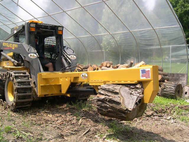

there are a few manufactures of these attachemnts out there. They all want around $2500 Here is a link to the best unit that I could find I would buy this if i didnt have the capabilities to build one. The only problem with this unit is the shape of the wedge when splitting hard woods.
Log Splitter for Skidsteer / Skid Steer / Loader / Compact Tractor - Quick Split - fits Bobcat and most other brands
I figure for $1500, not including my time I can build one.
Your ideas and comments are appricated!

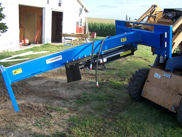

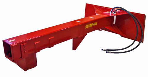

Here are a few SS splitters.
Last splitter is a double ram log splitter.
