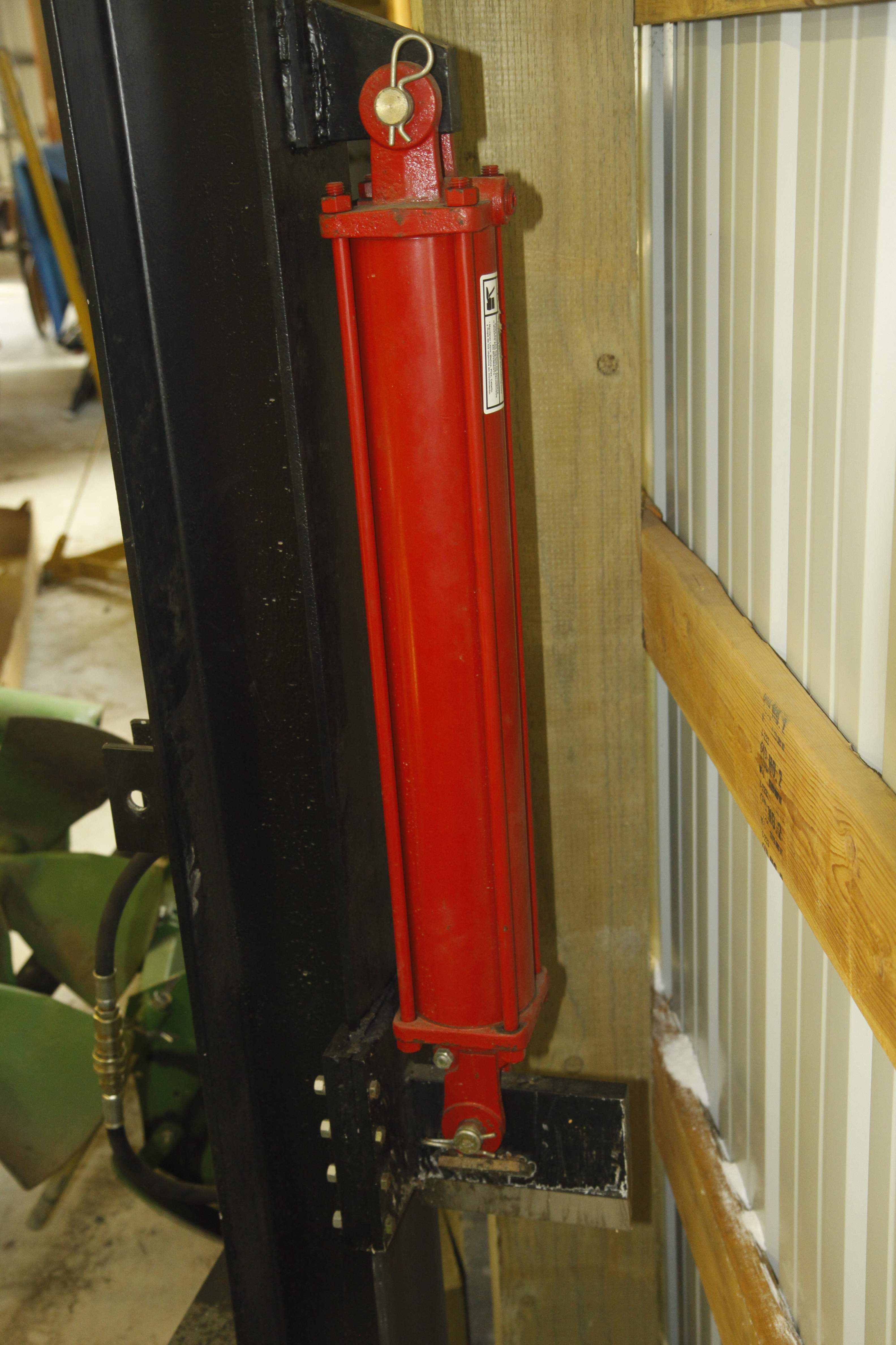

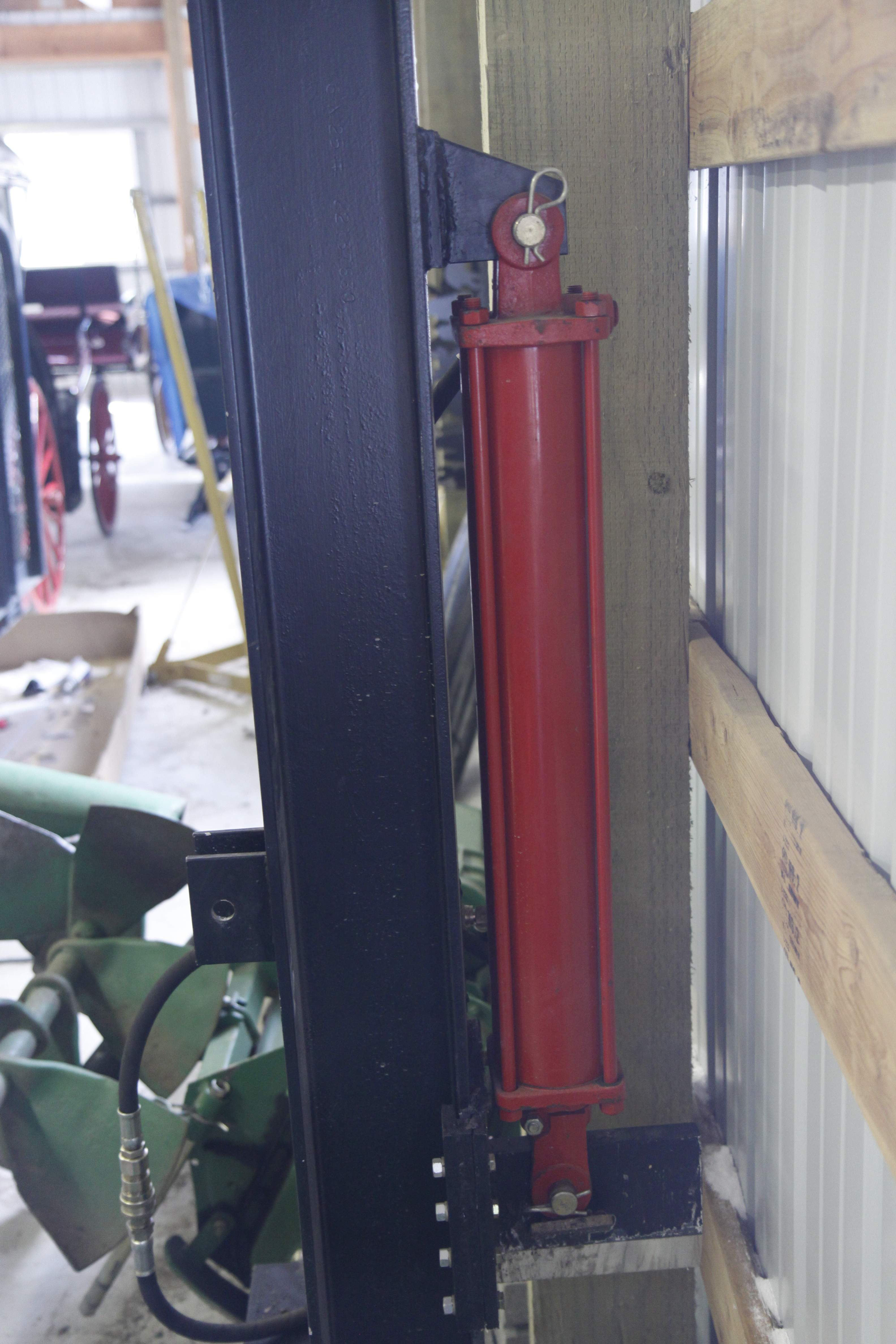

i love my wood splitter. built it myself for a couple of hundred bucks. i installed a power beyond system on the tractor for other reasons though. i wanted a hydraulic swivel for my snowblower.
that was a must . so, since i had the remote in the back, why not a wood splitter. its so much nicer to split wood when i want to, not when i have to to get the unit back to the rental yard. i hate splitting wood, but this makes it bearable.
as far as using the FEL levers to run the splitter? im confused. you need a control lever down at the area your working. not up by the seat. personally id add the power beyond/rear remotes. youll thank me later.:D :laughing: :thumbsup:
i can split wood faster than the wife can get it stacked. so just because some people think there too slow, it all depends on how truly lazy you want to be.:drink:
