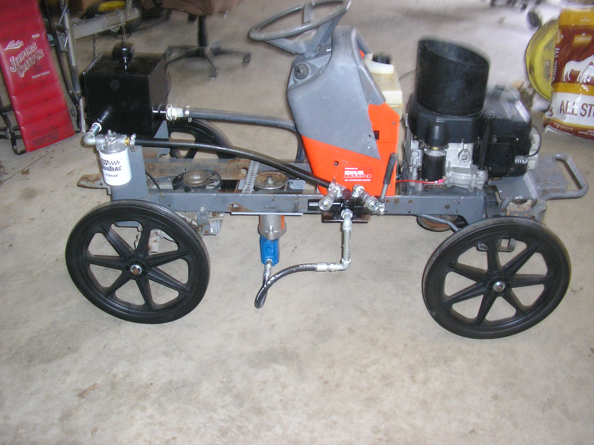

Rounding up pieces to build a 3 point log splitter to use on my Kubota and looking through the builds here I've noticed that some use a splitter wedge on the ram and some are stationary, any advantage or disadvantage of one over the other? Thanks!

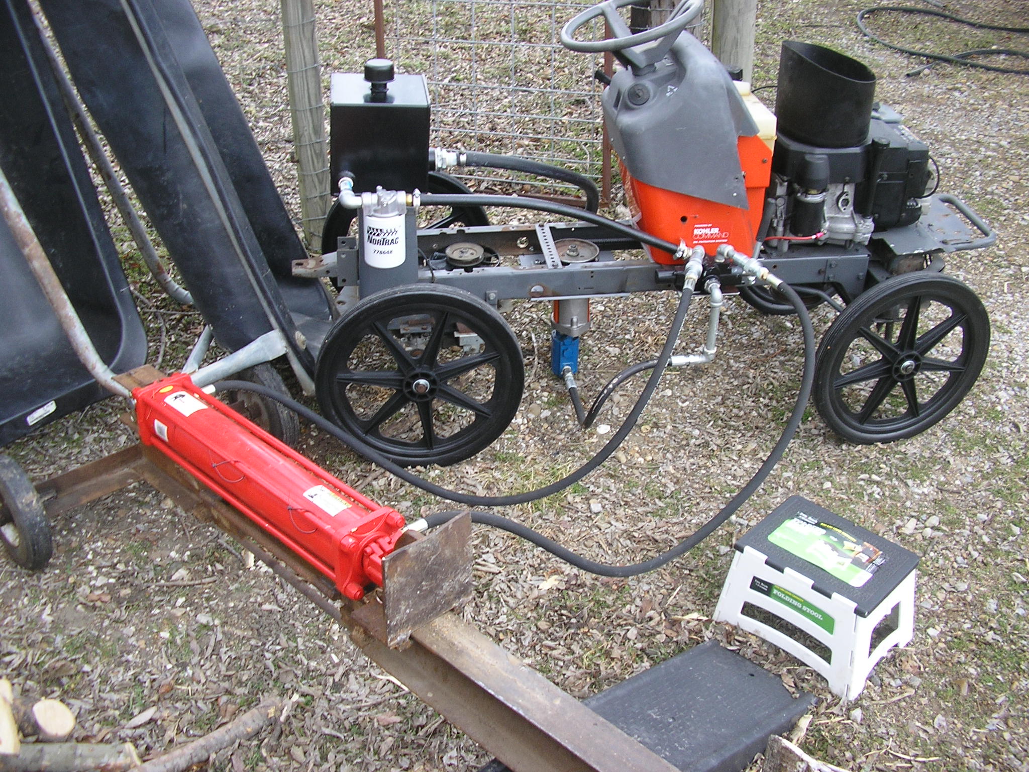

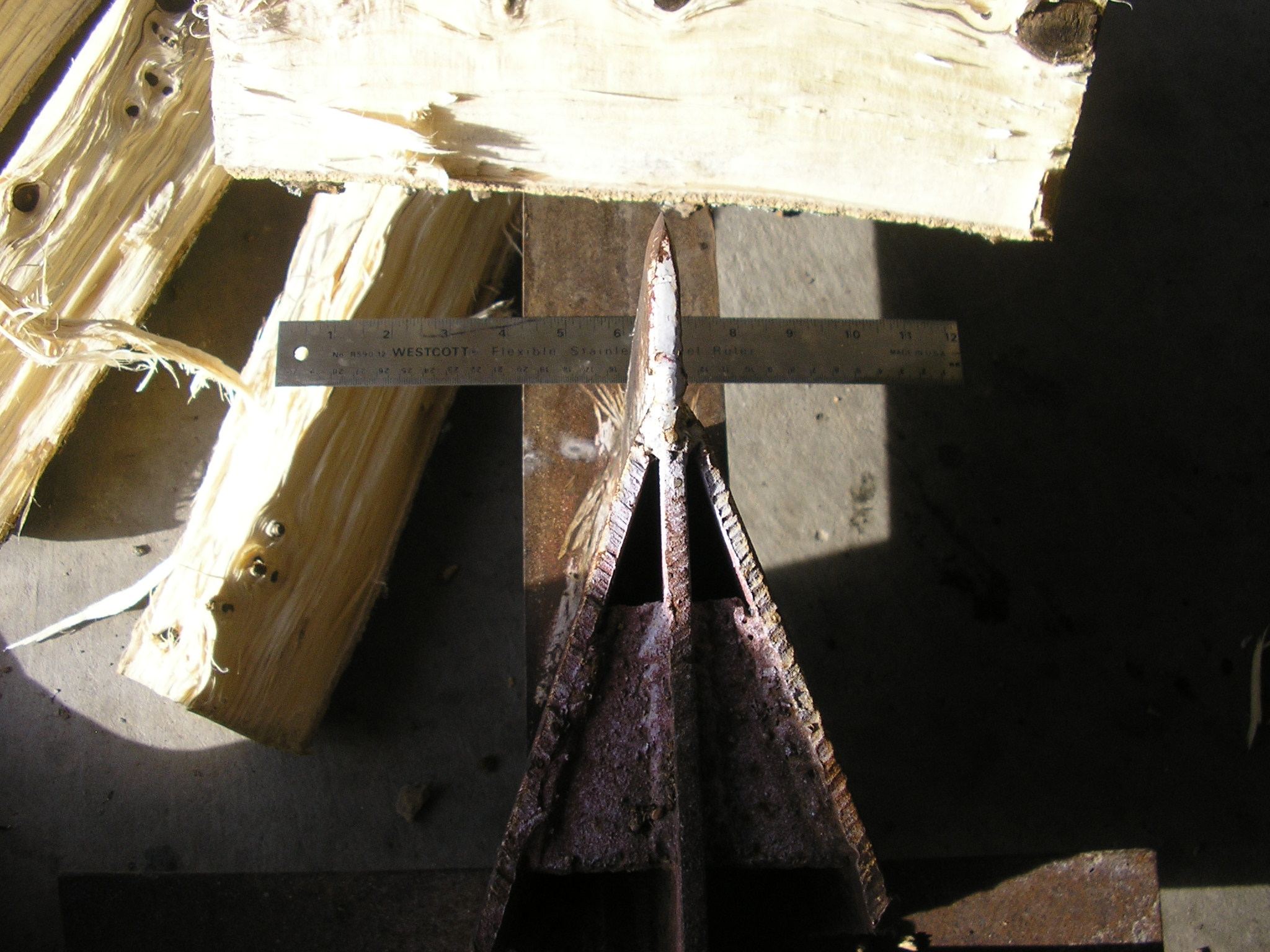

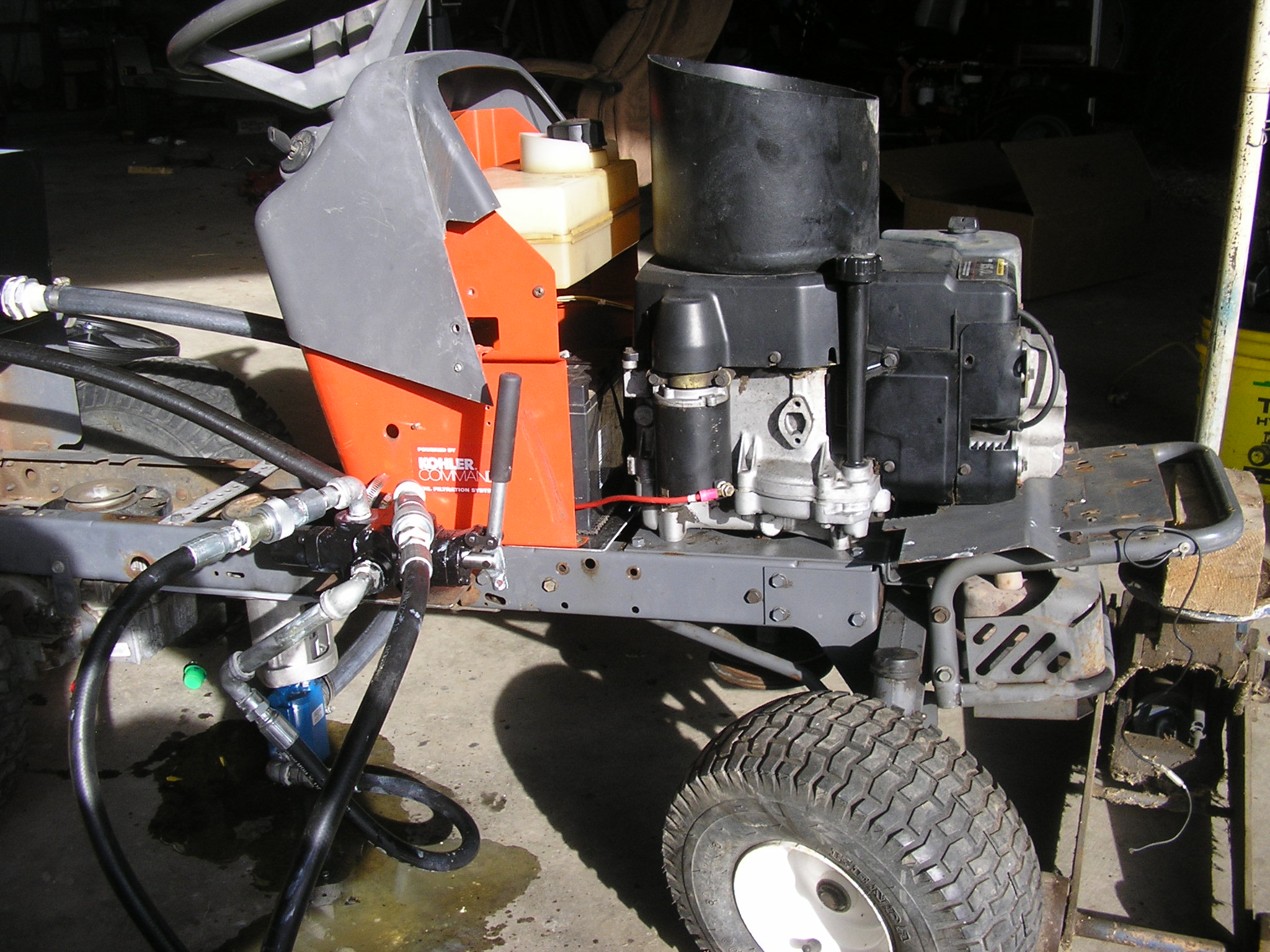

Since you are "Rounding up pieces to build a 3 point log splitter" I'll address that part of your post. I too once did that and my splitting device was a piece of thick steel as I saw on commercial units. I had low power due to a small diameter piston and had slow movement due to using a Ford 2000 4 cyl as the hydraulics source.
After numerous attempts what I found to work best was a modified wedge where you take what is sold commercially and about an inch behind the blade tip, weld deflectors to it. I'll see if I can find my pictures. If I do, recall that I started with the center wedge made of a single slab of steel.
These pictures are of the solution. In them I have upgraded the piston to 4x24 and changed out the water pipe fittings for regular hydraulic units. The rest of the cutter I had from earlier running with the tractor. The power unit is a 15 hp Scotts lawn tractor I had sitting around. Pump, splitter control, tank, filter, and Lovejoy fittings and all came from N. Tool. Pump is 16 gpm 2 stage, 8 hp requirement (engine is 15 hp), very reasonably priced. My cycle time is in single digit seconds, unloaded out and back. I built it near the ground so that I don't have to lift any heavy logs. I have a tractor with a FEL and bucket into which I toss the splits which go to my wood pile located in a shed...just dump them in....minimum manual labor as I can get for the money and time spent in the task.
As to which moved I'd say it may have been designer's choice to fit their intended package. It does seem that moving the wedge would be more effective due to the shape of the faces of the log to be split and friction of the driving mechanism. May be that moving the wedge worked better on irregular cuts of logs.
