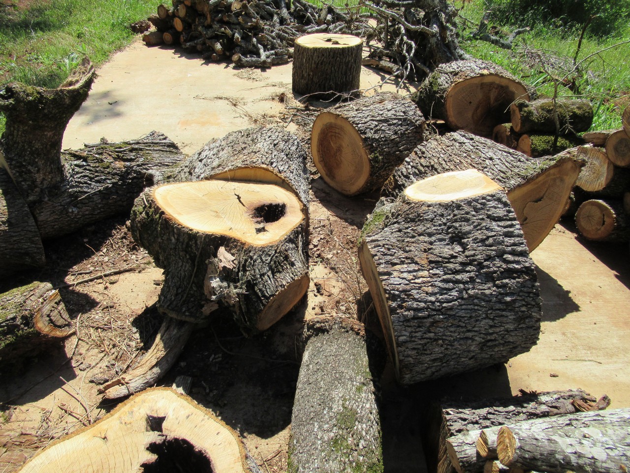

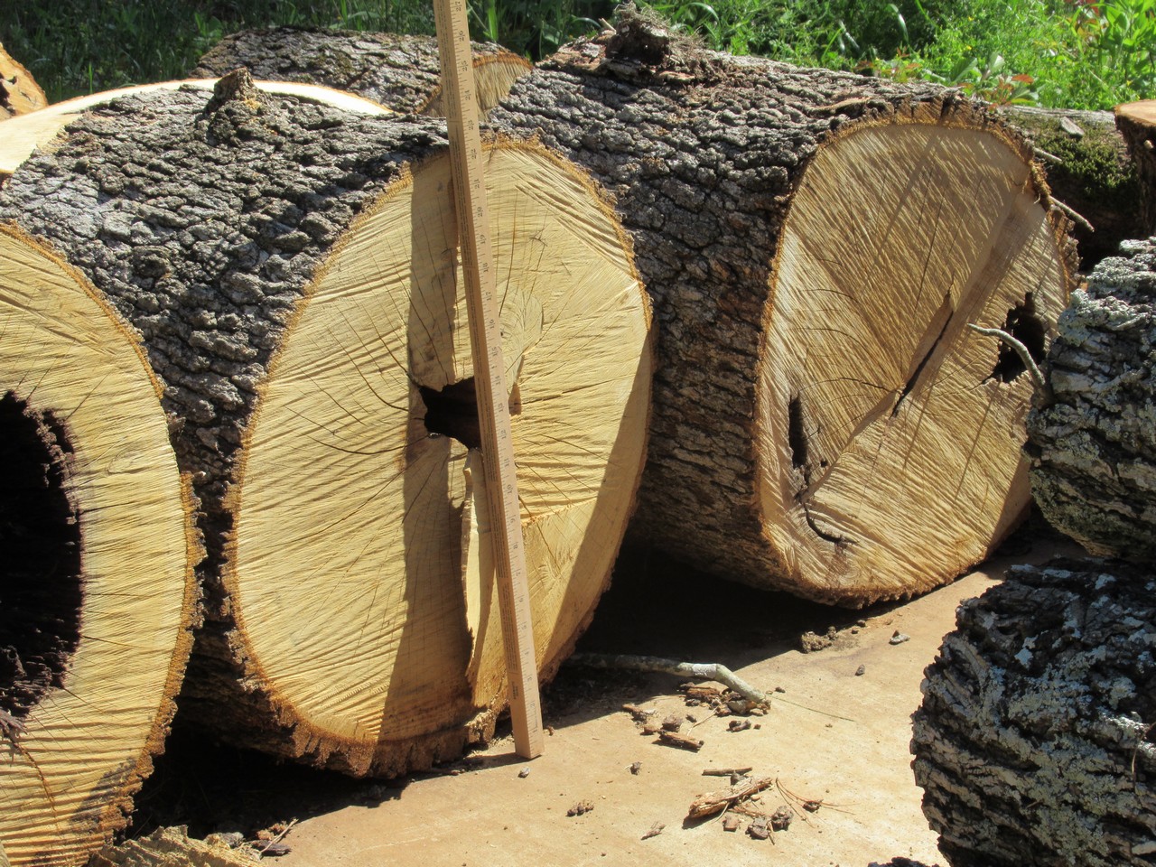

I had a big oak tree that appeared to be hollow and if it fell on it's own there could be a lot of damage. So, I had it cut down. I now have many 16" lengths of 24" rounds of white oak. They need to be split, some are from the crotch area with a large branch coming off the main trunk. I will have to have a log lift. I do have a tractor that can lift them, but maneuvering them with the tractor will be a problem so I can't count on placing them on the splitter with the tractor. So what size/tonnage/??? of splitter do I need to get? I haven't called the rental yard yet, but I need your advise to be sure I get a big enough one.

rent a vertical splitter, 20 tons will be fine. You don't need to split the ugly pieces through the tough going. Just lop off the good stuff and through the crap off into the ditch.
/ Log splitter size #3
My 28 ton Huskee would eat them for lunch. I've busted bigger than that. I stood it up vertical for the ones too heavy to lift and some of them took a few cracks to start breaking pieces off. It groaned and moaned a few times, but never stopped or gave me the feeling I was over taxing it.
/ Log splitter size #4
"noodle" cut them with a chain saw. That's cutting along the grain. Wood cuts much faster that way than the normal cross cut. It's a quick way to get rounds into small enough sections to be picked up.
I've not had good results from a splitter in vertical mode. It takes a lot of upper body strength to muscle a round under the 'foot' and hold it there while the wedge comes down. But my legs and back are strong so I can pick up rounds or sections of rounds all day. YMMV.
Splitter "ton" ratings are usually inflated. Instead look at the cylinder bore size. Common sizes are 4", 4.5" and 5". My splitter has a 4.5" cylinder and it splits tan oak and dry Eucalyptus without trouble. I've only had a few crotches that stop it.
