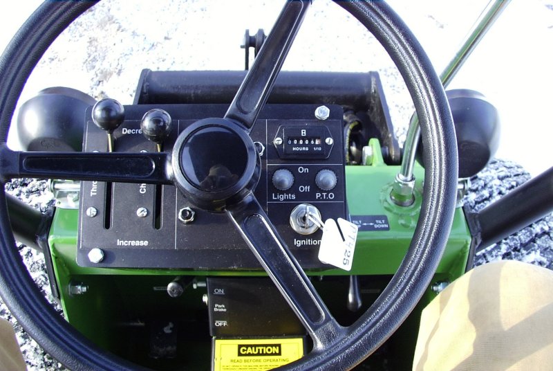

Very good description (and nice picture, too, by the way ;)). Notice in that picture the larger hose coming out of the left pump section and the smaller hose coming out of the right section. The left section (on my 2001 PT425) is the main PTO pump, rated at 8 GPM. The right section is the pump for the steering/lift/ and aux PTO. It does not flow 8GPM, but does flow a good bit of fluid. I think the folks at Power Trac said around 6GPM.
Now look at this picture.
The blue caps are the main PTO connections and the connections to the outside of both of them are for the AUX pto which operates the quick attach cylinder down behind the quick attach plate when... look at this picture...
You operate the lever that is just in front of your right knee, visible here, under the key tag marked 25.
If I were going to operate a log splitter, I would probably use the main PTO and an open center valve on the splitter. Then it would just be a matter of attaching the log splitter, hooking up the two main PTO hydraulic connections, starting the engine, and flipping the electric PTO switch (visible in the picture above, just above the key tag marked 25). You could adjust the flow with the throttle. That is how I plan on powering my backhoe. If it proves to be too much flow, I could always connect into the AUX PTO instead, but then I would have to find a way to hold the AUX PTO lever up or down to get flow out of that circuit.
