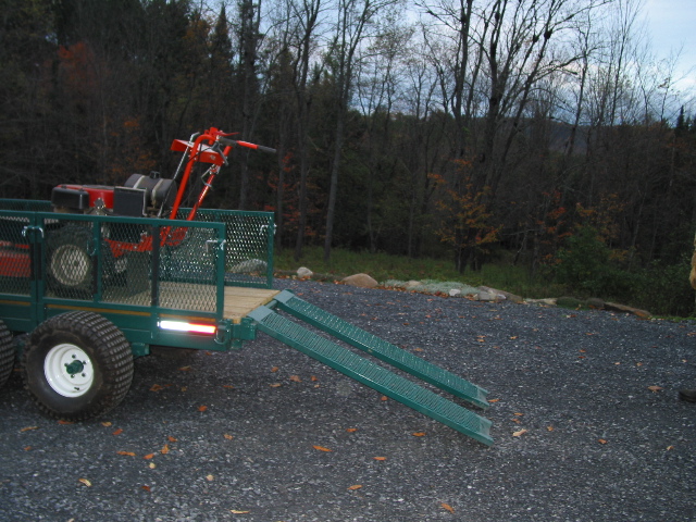

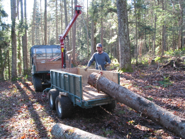

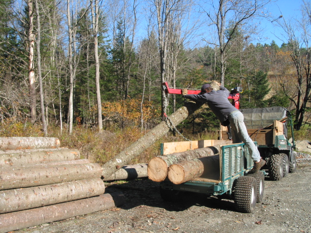

Here are a couple more pictures of my trailer doing different tasks that may give you more ideas.
1) All the panels are removeable, so in the first picture I've got 20' culverts loaded up so I can take them out to their final locations on my trails. With the front and back panels removed this was pretty easy. I also had a custom hitch built that allows me to expand the tongue length from 2 feet up to 6 feet for when I'm moving really long objects.
2) The next two pictures show the ramps I use to load up my DR field and brush mower so I can take it to the back 40 quickly. The pictures showing the front of the trailer shows where the log boom fits in. It is pretty simple actually, just one of the 50 gallon booms you see on the back of pickups. But it has all the flexibility I need. I can pump up the angle of the boom. I can extend the boom from about 4 feet to 7 feet in length. I have an electric winch on top for pulling in the logs.
The only pictures I can't find are of the dump body in action. The entire bed raises about 6 feet in the air. When the body is slightly raised you can also see the storage well under the trailer where the battery is with the hydraulic pump for the dump ram.
I think it has been three years now that I've had the trailer. It cost me around $3500 back then. This was the first one they built like this and I don't know if they made any money on it. The next time around it would certainly cost more especially with the cost of materials. But I got exactly the trailer I wanted and it will last for my lifetime.
I have learned a couple things about this trailer that I didn't realize as much ahead of time. With two axles this thing does not turn easily. When I have it on the cement floor in our barn it takes some effort to manuver it. The tongue weight is very heavy. With the boom up front, and the battery and hydraulic pump in the front third it definitely drops my Ranger's suspension.
Think about what you want in a trailer and talk to Nichols about what they may be able to build for you. Everyone has different needs.
