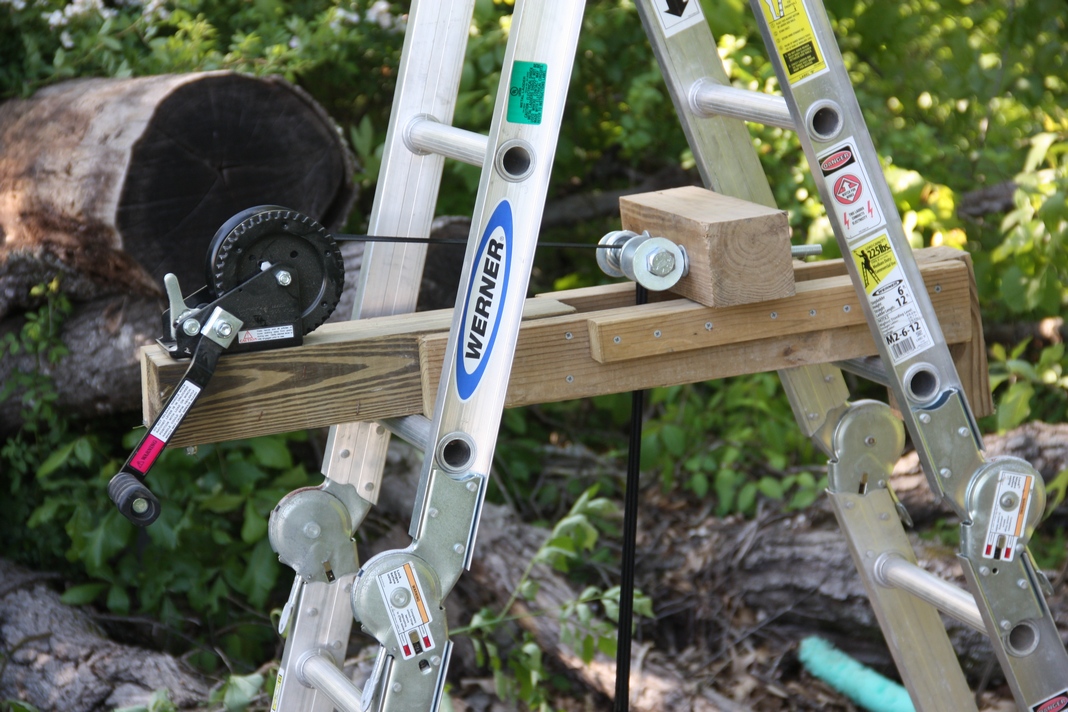

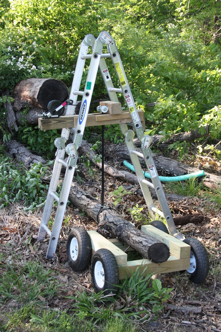

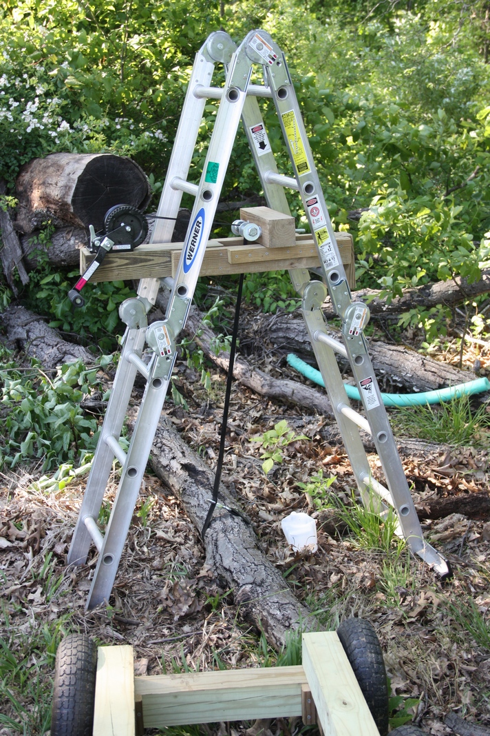

Hi All,
I wanted to avoid a bit of confusion about how this actually works. I actually considered threaded rod, but since it would have to go through 2' of 4x4, it just did not seem practical. In effect, the 4x4 is the axel for strength purposes while the lag screw is the axel for bearing purposes. It has been mentioned on this thread that an arch structure could help. What I did instead was use some materials at hand, buy a little hardware and one hand cranked winch. Here are a few pictures. I admit, they are posed, but they do show the intended purpose. Normally, the tractor would be at the other end, but these pictures show how the arch (a well-built stepladder), and a marine hand winch attached to some left over 4x4 can be used to lift a surprising amount of timber just high enough to get onto the log trailer.
As always, any thoughts are appreciated.

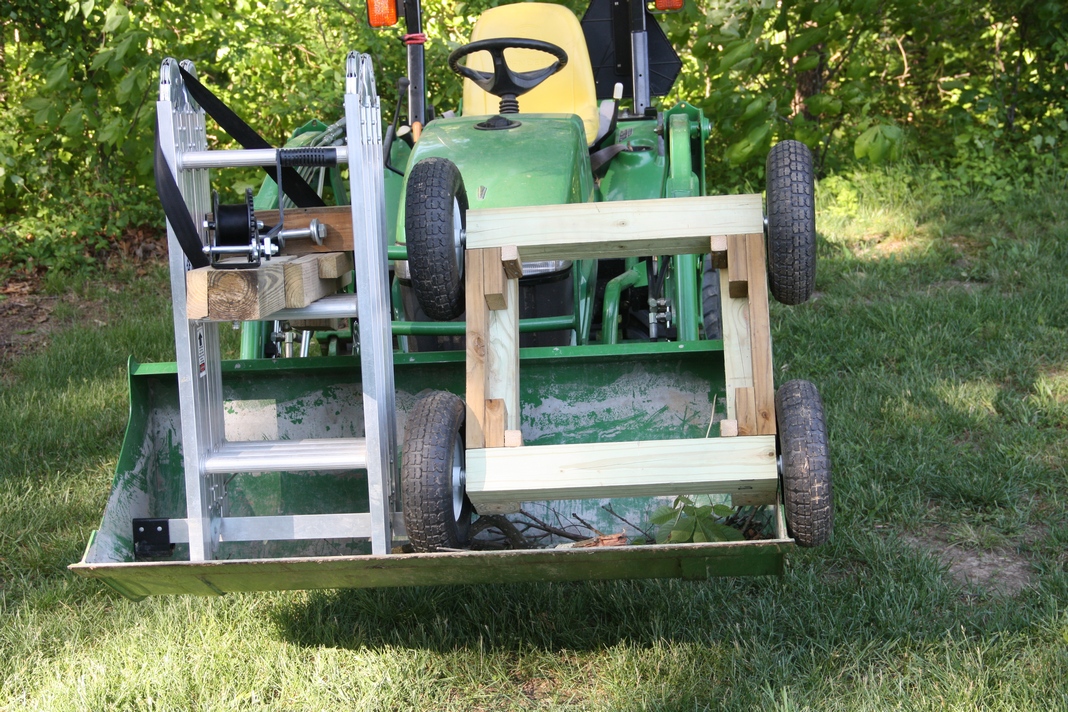

Finally, this can be packed up and stashed away in the garage and basically disappear into the clutter or it can be loaded into the bucket and hauled to the worksite.
