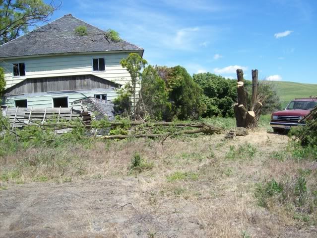

I pull logs around that size all the time with my F150 2x. Of course I work with many snatch blocks and lots of cable sections. The rigging needs to be designed to multply the pull. A single pulley on the load will half the load, anothe rpulley on the 'pull' side of the first pulley cuts the load by 4, etc. Only had to add one more once and then couldn't budge it.
My firewood making tools. all of that goes with me on every trip out.
I carry 4 snatch blocks and over 150 ft cable in several sections. Been more than once that I used all of it except for one snatch block on a pull.
