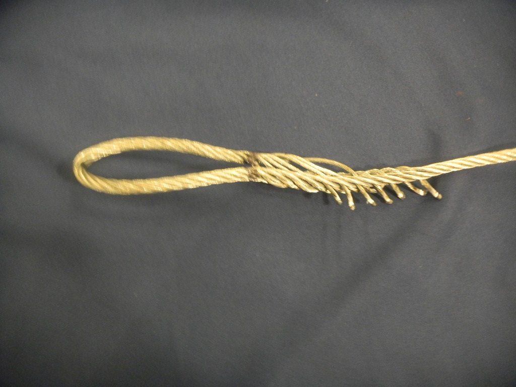

I think the biggest problem you'll see with the eyes. Is people don't follow the D-Factor rule, and use to small of a shackle. Which that will cut the eye, not pull the eye apart.
I put a chain around an old stump this morning, and started the tractor so I could pull the chockers tight, and melt the ends of the strands off closer. Makes the eyes look a little better.

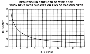

   / Logger's eye. #29
I knew a small shackle, etc. made for less strength, but not what size and how much, so I had to look it up. It looks like a shackle in an eye causes less problem than the main line going around a small item. like in a sling. More good diagrams at the link.
Bruce
From:
[h=1]D/d Ratio and the Effect on Sling Capacity[/h]
The D/d Ratio is the ratio of the diameter around which the sling is bent, divided by the body diameter of the sling.
Example: A 1/2" diameter wire rope is bent around a 10" diameter pipe; the D/d Ratio is 10" divided by 1/2" = D/d Ratio of 20:1
This ratio has an effect on the rated capacity of slings.
Eye & Eye Slings
The LOOP of an eye & eye sling has nearly DOUBLE the strength of its body. For this reason the D/d ratio in the LOOP is just half as critical as opposed to when the sling is used in BASKET hitch.
If the shackle body has AT LEAST the same diameter as the sling (D/d 1:1) the capacity need not to be adjusted.

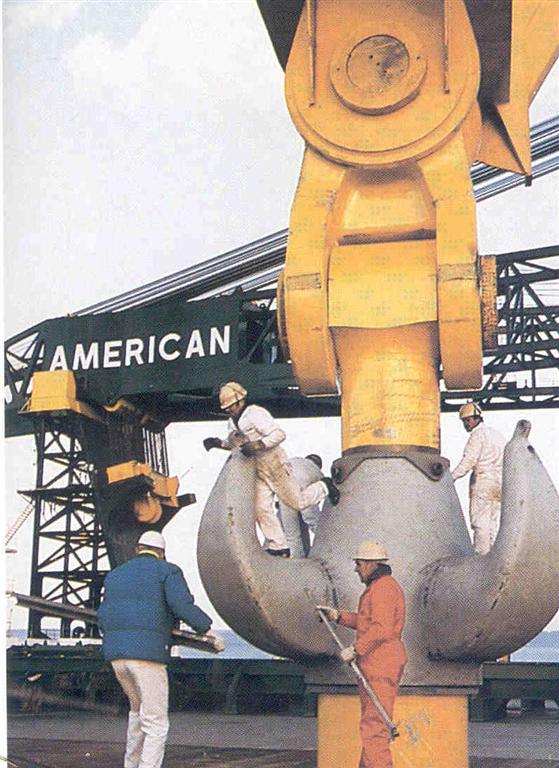

#30
You would have to have a pretty big choker for this hook to cut the eye! :laughing:
