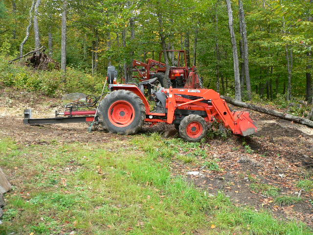

I looked into buying a hydraulic winch to go with my log hauling frame (see picture). The best solution I could find was from Mile Marker, they build winches that run off of the power steering pump for the recreational off-road vehicle market. One of our members here, 6sunset6, did get one of these working for logging, and found it worked well for him. Search to find that thread. If you go that route, check pressure and flow requirements/restrictions.

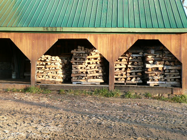

After logging for a couple of years for my own fire wood, I came to the conclusion I badly wanted/needed a winch. Putting up 10 cord without a winch was a LOT of time and labor. Once I started spending winters at my farm full time instead of just weekends, the fire wood requirement doubled. I need to have a minimum of 20 cord seasoned and ready to burn every year.
I just couldn't do that with out consuming a lot of time and taking risks I didn't like.
I bought a used Farmi from a member here, who bought it from another member here, who I understand also bought it used. It is a 13,200 # winch and I run it on the back of a Hesston 100 90. It is nearly a perfect match for that tractor.
I did replace all the bearings in it, which was a fairly easy job, (excepting for the weight of the wire spool).
I purchased it for a fair price, and it has been the best cost / benefit implement or maybe tied with my TPH mounted splitter, that I own.
I have put up prox 80 cord in the last three years, and there is no way I could have done this without the winch and TPH splitter.

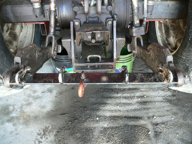

I also fabbed up a skidding bar for times when the logs are already lined up fairly neatly and i just need to do a pull from the log yard to the wood shed, cutting yard.
