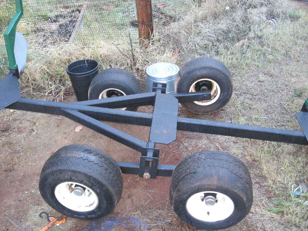

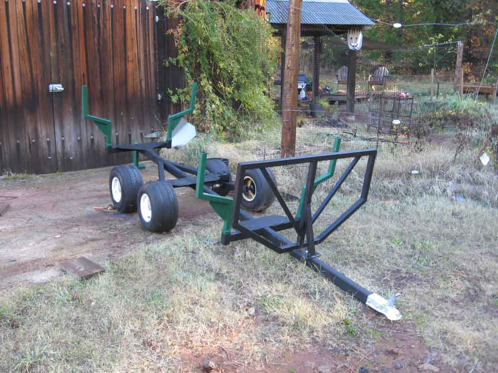

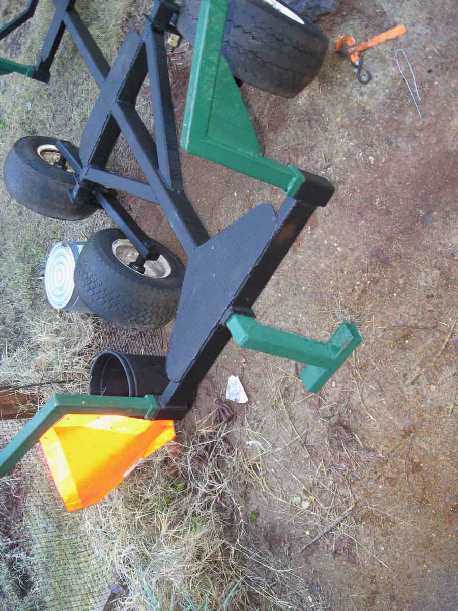

Hi All
just finished up this logging trailer. Had to add some reinforcement to the cross members the axles attach to after accidentally stress testing it with the loader bucket when loading a log.
Otherwise it works great, need to get some new tires soon. The green part on the end acts as a support so it doesn't flop backwards. All the materials came from the remnant rack at a couple of local metal dealers.
Thanks for looking
Tom

That'll be fun. Get some pics with logs on it when you can! :thumbsup:

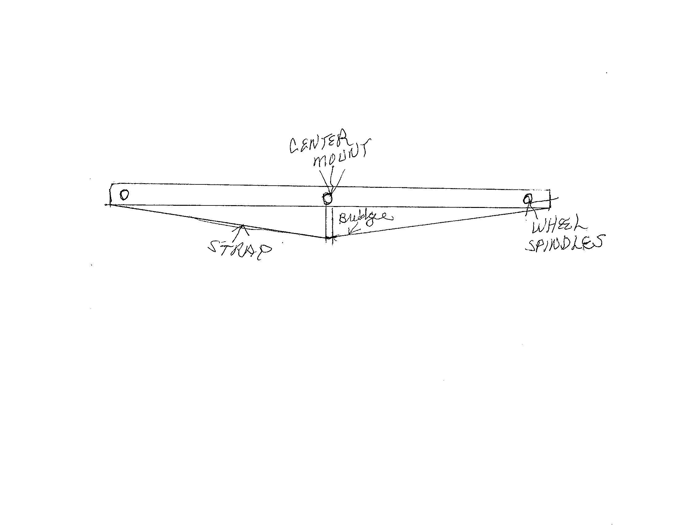

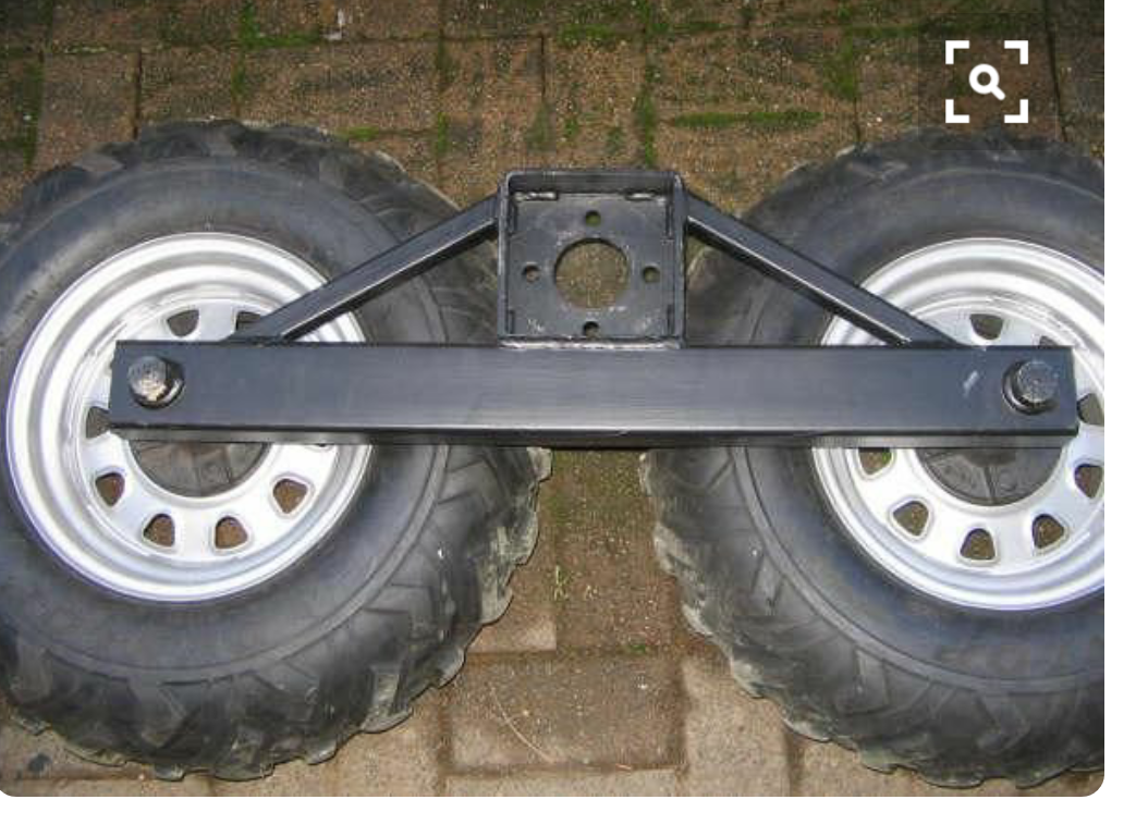

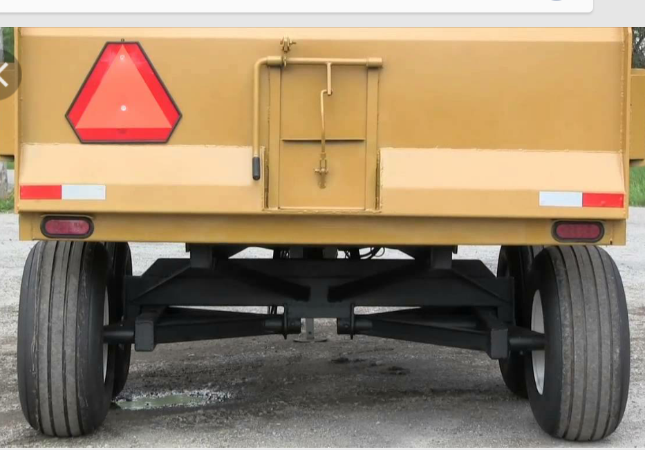

Trailer looks great. Wood is heavy I would add a bridge kicker under the metal for the axle. Can't tell by the pictures, do you have a 45 deg. brace from the beacket holding the axle to the inside?

I've thought about doing just that under those bars, just thinking about how to do it. no braces but those plates are 1/4" and slide over that tube like a mortise and tenon.
Thanks for the comments they give me ideas to ponder

What is a "bridge kicker"?
