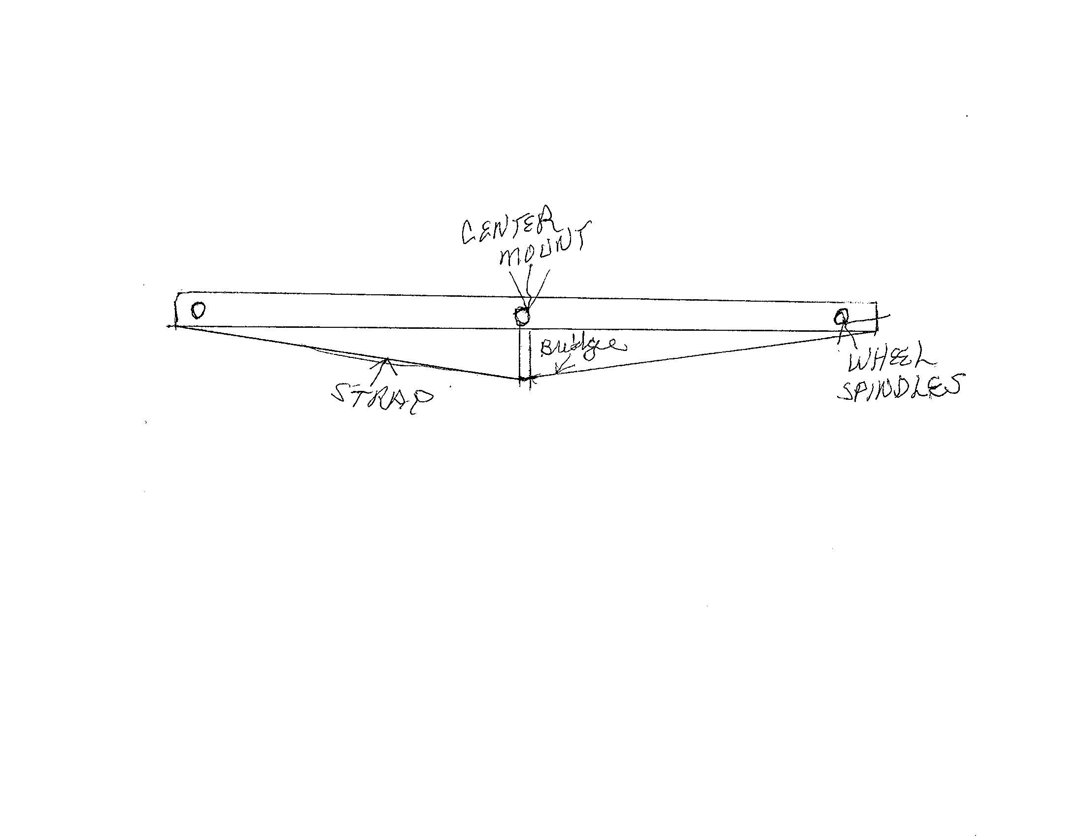

King post and truss rod or strap to me.
Bruce
   / Logging trailer
#14
the green thing comes out easily and is just used when loading to keep the back end from popping up.
I like the bridge kicker idea gotta think about it a while, my plan was to make something similarly shaped out of 3/16 plate
Tom
   / Logging trailer #15
You might call this something else, but that is what I have always call it.
I would prefer a boxed bridge, as a boogie arm is mostly loaded with torsion. straps add nothing to the torsional rigidity.
   / Logging trailer #16
You are right about the torsional rigidity.

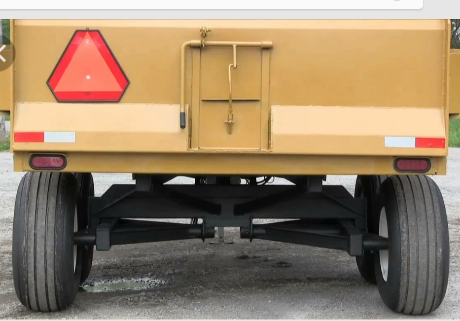

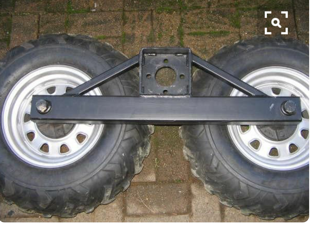

Nice build, just a few ideas for the axle I've kept up with.
