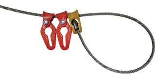

As long as I'm here....watched a video of some Euro loggers using larger tractor and winch. They were working in some very nice spruce. I noticed the cable end was just a loop, and the sliders on that winch had grab hooks. Seemed very efficient-just get that loop end under and around, and set it in the slider hook.
Seemed faster than what I do anyway!
for sure it is fast. Easiest way to push under a grounded fallen tree.
This is the type of knob and bantom I use on mine. pushes under a log easily and hooks firmly in seconds
I also have 2 keyhole sliders so I can pull 3 logs at a time from almost 200' away
and these are hands down my fav. chokers for the keyhole sliders. The metal rod on the end makes feeding under a downed tree easy.

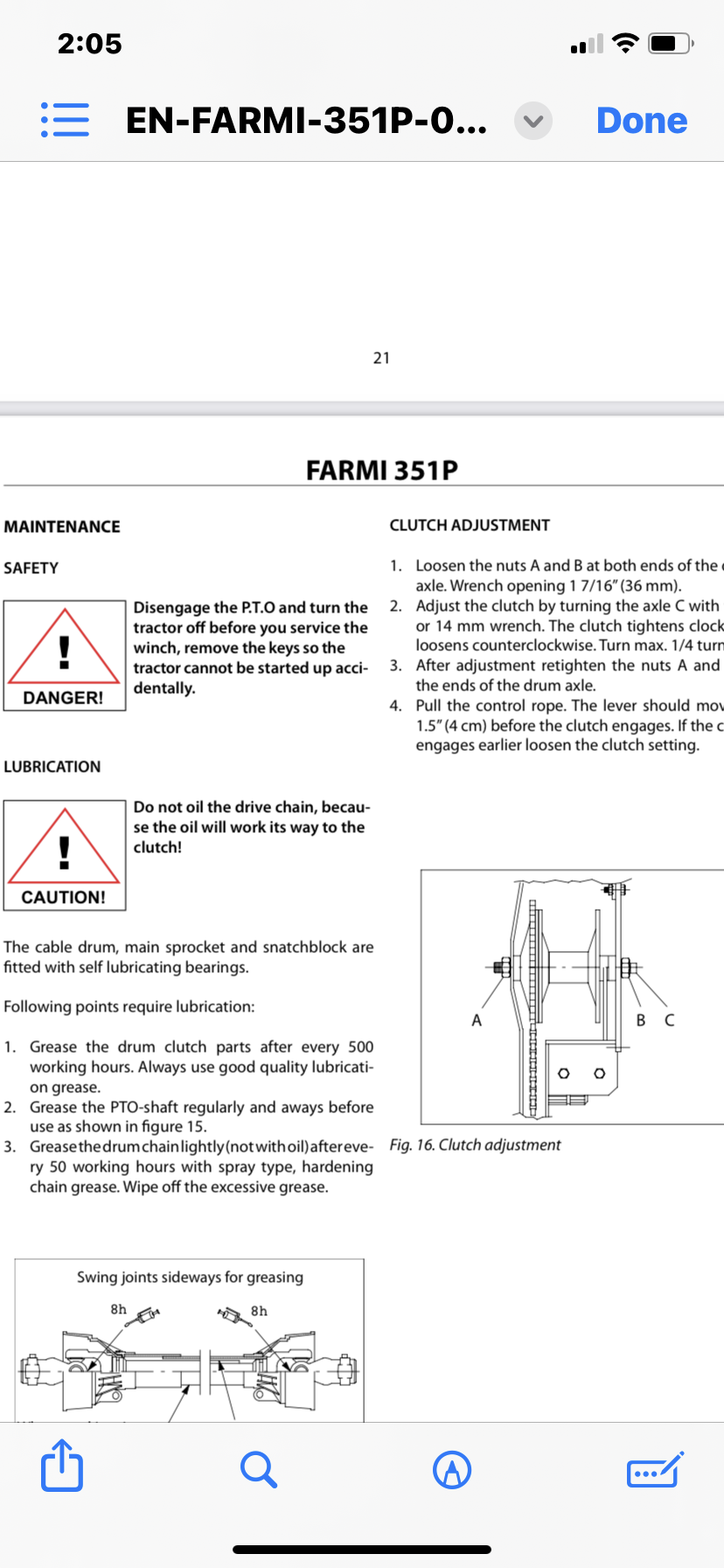

Farmi specifically says not to lubricate the chain.
good catch!!... seems Farmi wants grease not oil to lube the chain....devils always in the details and why owners manuals and WSM are important.
My Wallenstein says oil every 50 hours.
