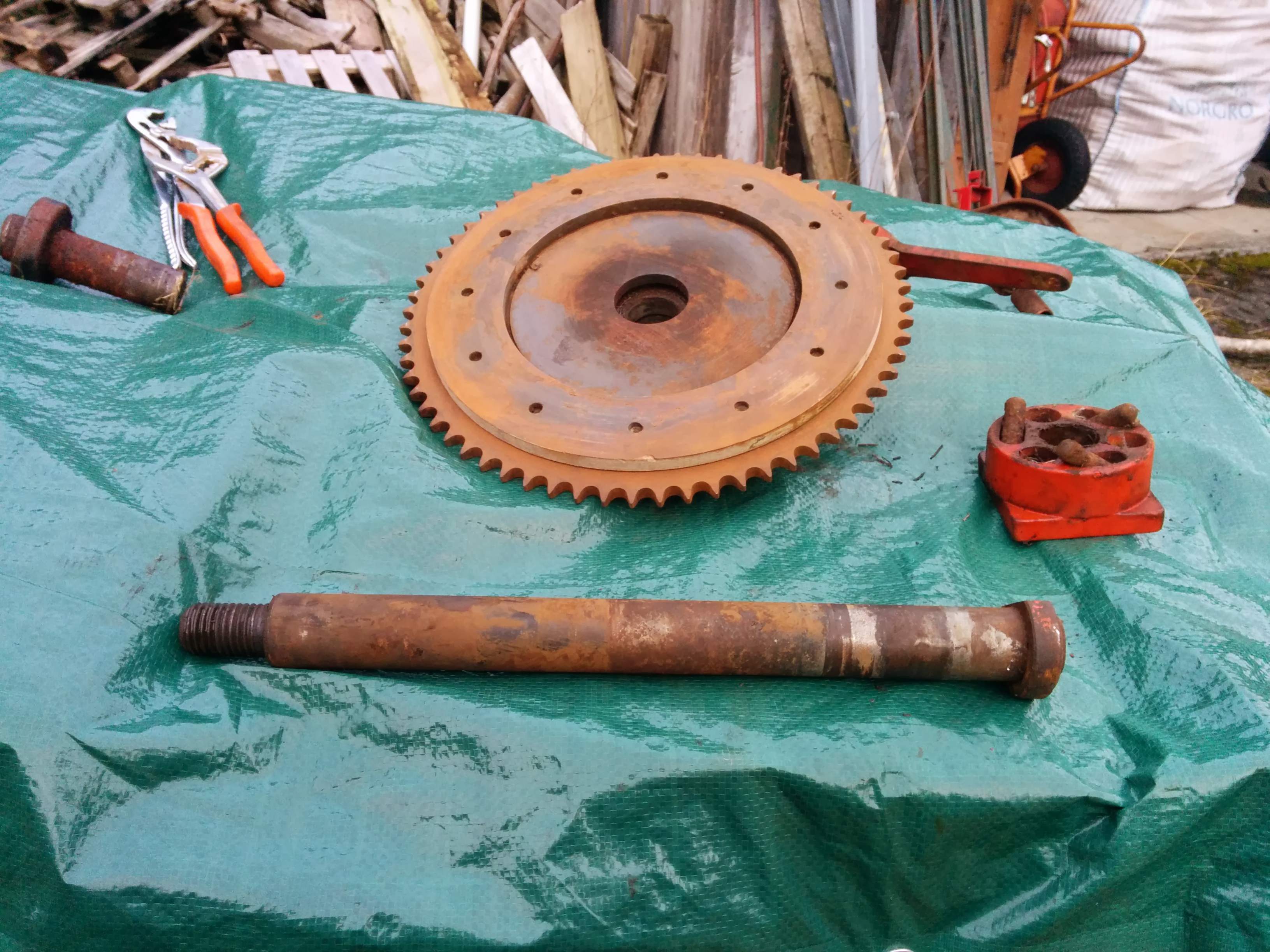

We are considering building a PTO powered logging winch;similar to Farmi,ect.Does anyone know a source for the clutch that we would be using.We have the capabilities of building the rest.

Search this site for guys using drive axle. PTO to driveshaft, wire on one rim, breaks on both. Keep the breaks under separate control. Apply Break to wire side for skidding. With PTO on and wire break on the other wheel will spin. Release the wire break and apply the breaks to the other side of the differential to wind in.
Not pretty but works.

You could bolt, rivet, or weld common automotive disc brake pads to the pressure disk.
   / logging winch build #4
A clutch workshop should be able to cut a suitable friction plate, you can glue it to the drive wheel.

Here's just me thinking out loud. Couldn't you just bolt a regular automotive style clutch to a sprocket? Then parts would be fairly common.

An automotive clutch has one too many friction surface faces. But could make a useful material donor.

You might be able to adapt a centrifugal clutch of the type they use to build GOCARTS.
They operate like a chainsaw clutch except bigger and can handle more horsepower.
Then there is the electric clutches used for air-conditioning in cars or again those used on riding mowers when a snow blower is front mounted.
Naturally when not engaged they then free wheel so a brake would be needed.
