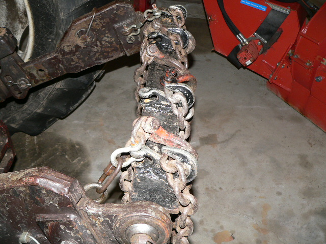

I don't like the physics of the auto rear axle housing design. The axle housings are attached to cars or trucks near the out board end, where all the forces are. I see in my minds eye the end of the axle with the spool on it, snapping off the differential housing, when sufficient force is applied. The other issue is that winching in with that leverage applied puts stresses on the lower links and tractor stability, that neither was designed for.
If utilization is 10% of design limits, prolly be ok, but hoky at best.
Before I had a winch I used long lengths of chain with chain hooks on both ends. string chain to log, pull via tractor to a staging point and then skid several at once to cutting yard with this rig.
