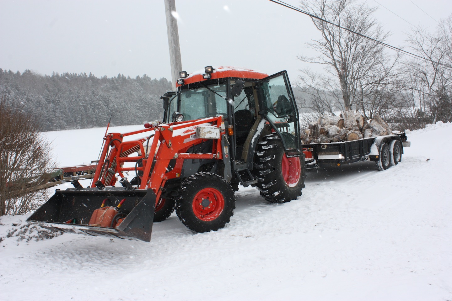

3rd load... hopefully another 3-5 more will be available. Been bloody cold up here so I haven't had a chance to bolt on receiver. Averaging just shy over a cord of wood per load.
I left the trailer at the base of driveway - no place to park trailer and the driveway is very steep. I shuttled wood via loader down the hill and dumped on trailer. I have been cutting, hauling and trailering home in the AM and splitting and stacking in the PM... kids and wife have been helping to put the wood in the shed. This will last us for the next two years. - hopefully. We have been burning more this winter - extreme cold and more snow than previous years.
