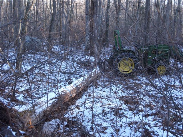

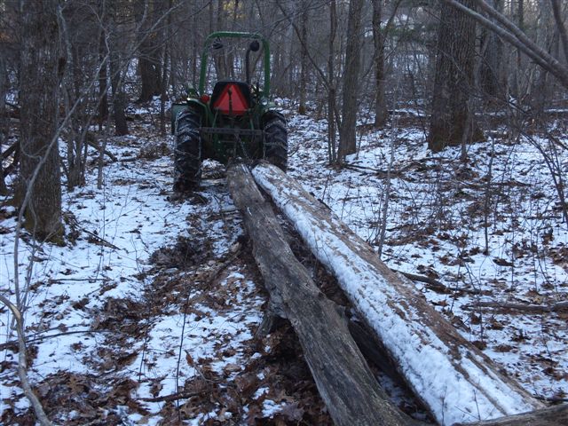

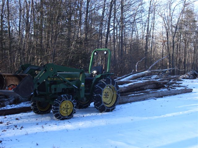

Luke, the logs one can skidthrough the woods does not have so much to do with tractor hp but tire size and type, ground clearance and traction. Popping beads thru the woods should not be happening so first check tire pressure and then make sure you have the correct rim to tire size especially if you bought the tractor second hand. Below is a pic of my JD 750 with a wopping 20 hp. On that second picture, you can hardly make it out but the tree is a blow down that when falling, got hung up and almost cracked in half. I trusted the 750 to finish breaking the tree and then pull the hang up down. Worked just right and didn't even have to get off the tractor (except to take the photo) for a rehitch.

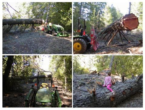

In the picture my JD 3320 looks pretty small next to the tree. I was able to pull it over and pivot it around so I could get past to some other work with the Farmi (hooked up for pull on lower left). I didn't get a chance to buck it into logs to see how long a section I could skid before the guy with the excavator came in. I have one fir down that is half again larger in diameter that I will fool around with when I get time. Clair is riding her whale.

Too bad. We could of started a pool as to how long a section the 3320 would skid of that fir.
