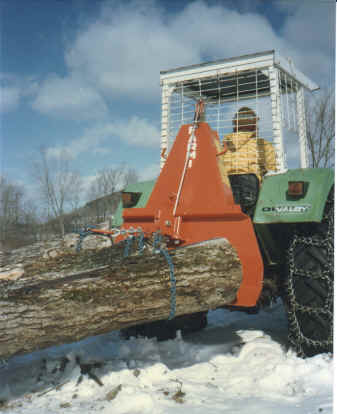

I use a Fermi 11,000 # winch on a Ford/New Holland 2120 43 HP tractor and have not found any logs in New England that I cannot drag. The winch comes with 165# of cable and I use a few 25' 5/16" Grade 70 chains to extend it I need to. The one accessory I find very useful is the self releasing snatch block that allows you to pull trees around corners. With the Fermi winch you can hook a number of trees to the winch and then lift the 3 point hitch, raise them and pull them out together. The blade on the winch anchors the tractor to the ground real well and also is good to fill in ruts. The one thing I learned from the Farmi manual that wasn't obvious until I thought about it was to fell the trees with the small end toward the tractor. That way you are pulling a wedge, pointed end first and it takes far less energy. My gut would have told me butt end first. For more info see: http://www.northeastimplement.com/index.htm
The only thing I want to add is a safety note. Always pull as close to straight off the back of the tractor as possible. Only a few degrees off and you won't believe how fast a 6000# tractor will flip.
Hope this helps
Andy
