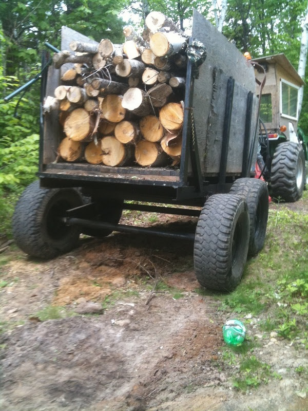

I have a kubota l4740. It is 47 horse power with a Wallenstine logging winch. I also have a logging trailer. When I am skidding I can twitch out 1/3 of a cord in good going. When using my trail I usually go with 3/4 cord.
