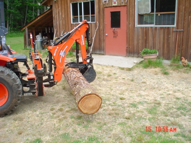

could anybody tell me what is the best way to haul, carry, or drag logs that were cut down about a year ago to a place to cut in to smaller chunks?
/ logging #2

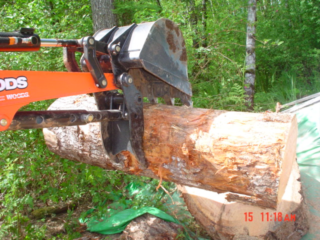

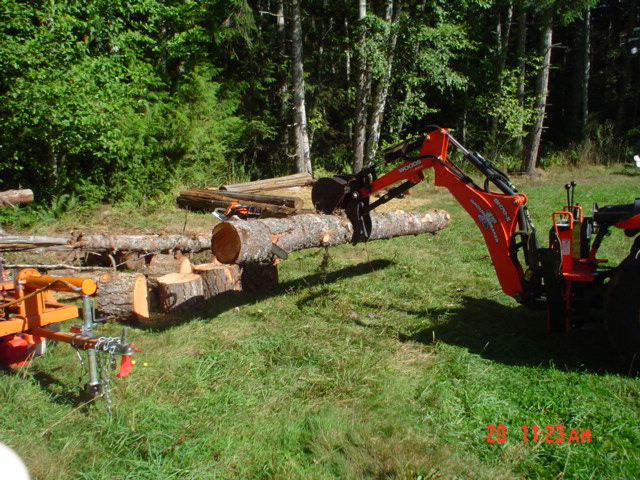

I have cut some into 8-10 ft long pieces and used the backhoe to take them out. Some logs I dragged out with a chain wrapped around my front end loader. Depends how big they are. Lots I have cut into rounds and sometimes split them at the same time and then bring out the split wood. Decision varies on where the tree came down. :)
