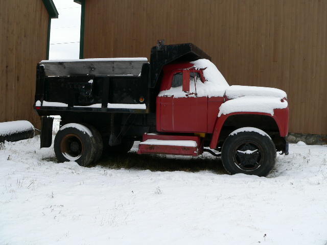

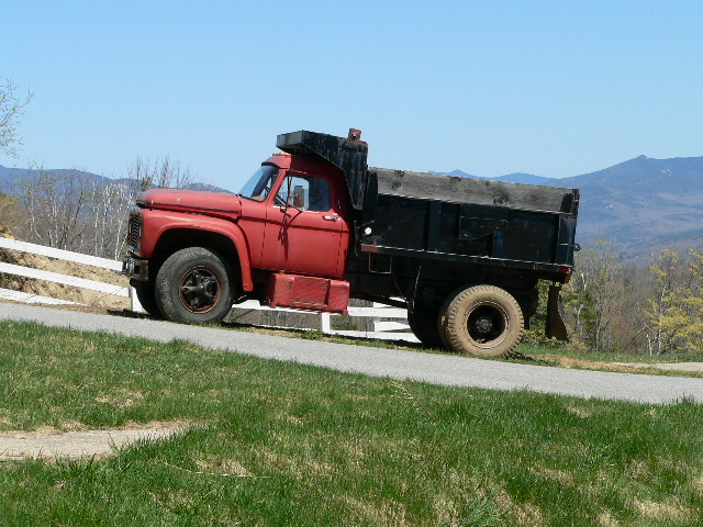

For moving rounds that size I bucket them out of the woods to this.
From there they go to the splitting yard. I only use this method when I cannot skid the whole tree out for some reason.
