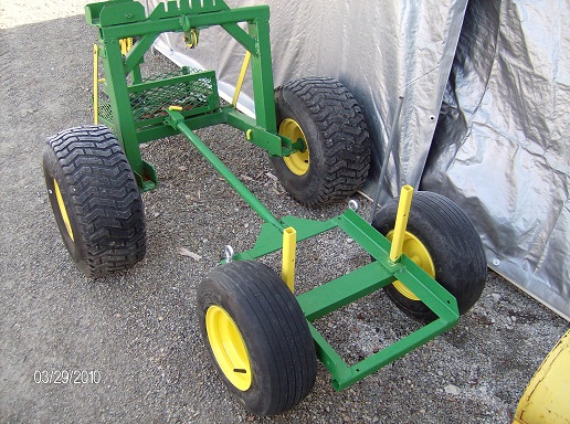

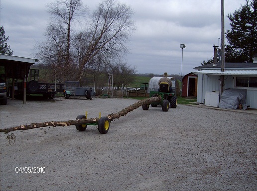

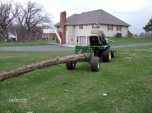

Sometimes I use the Mule & cut up in the timber. Sometimes use the JD 420 w/log arch & bring the poles to the pile to cut up. This year I have the JD 790 & pallet forks, I can bring the poles to the pile & use the forks as a sawbuck!
I store my wood at the farm through the summer, then bring it home to split, stack & cover. ~~ grnspot110
I like your logging arch. I've thought about making two, one to two behind the tractor and a second that could be used to raise the rear of the log up off the ground. I have lots of mud, not deep but still dragging a log through it would make a mess.
Thanks!
I do have a trailer for mine, long tongue to tow behind the arch & help in lifting end of log. ~~ grnspot110
Now that's an interesting idea..
The nice thing about the arches is that they can be used as a lever to lift the butt up into place, I added the winch to mine to pull stuff a few feet that I couldn't back up to.

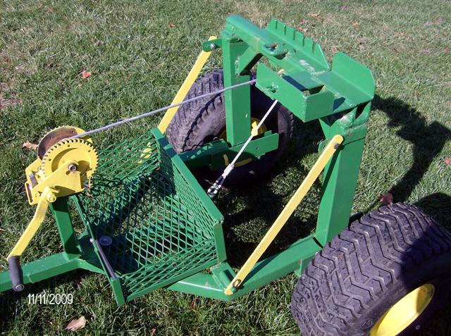

Sean
I use a winch on mine to lift, but use chain to pull. ~~ grnspot110
