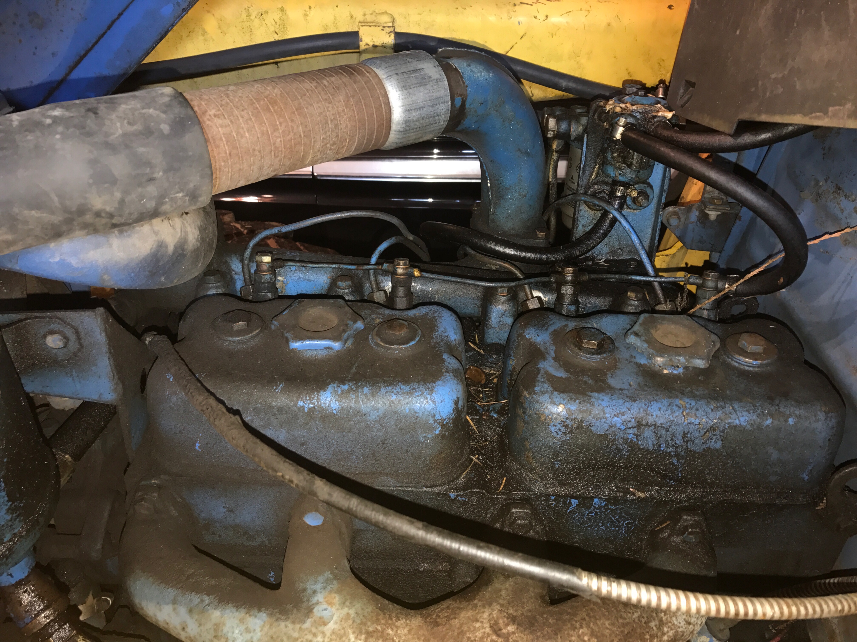

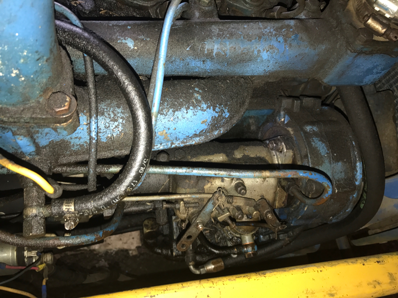

Hello ladies and gentleman,
Can anyone help me find a wiring diagram for a 560 dt long tractor? It only has about three wires on the whole tractor.
Thank you,
ac

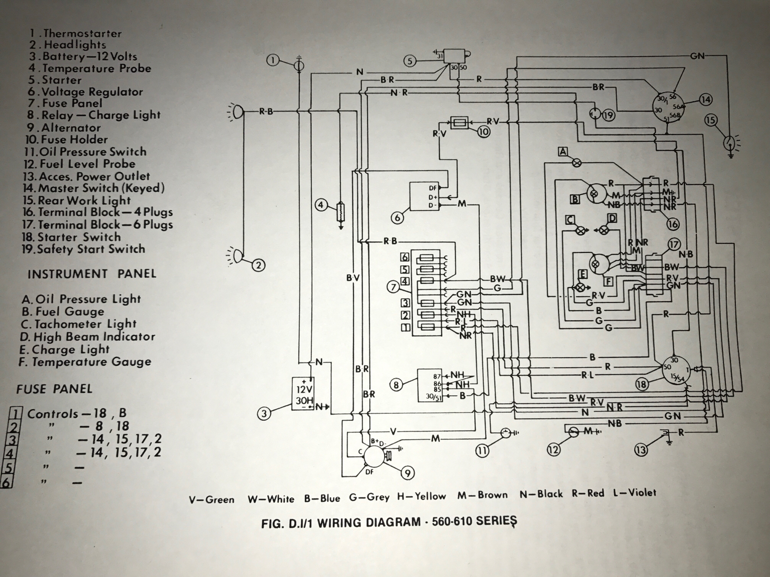

Thank you much but unfortunately with no serial numbers listed on tractor data website it's no good. Too bad it's no ih, so much easier to work on.
   / Long 560 or 610? Help
Re: Long 560DT Wiring diagram help
Found one: IMG_0299.JPG
   / Long 560 or 610? Help #5
I have a Long 360,460,510 repair manual. you should be able to get a good idea from this.
