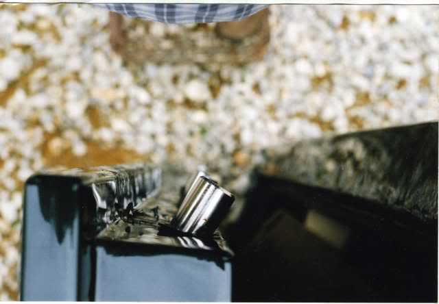

Read the following thread, and pay attention to the details and pictures I posted on pages 2, 9, and 10:
http://www.tractorbynet.com/forums/rural-living/217701-gun-safe.html
On page 9 of the link above here is a nice picture of a Winchester "safe" pried open with a Hi-Lift jack. Then there is a picture of a Remington "safe" opened up with two big screwdrivers and a prybar. :confused2:
Summary: most of the RSC's listed so far in this thread can be opened with little more than a pry bar, and in addition they use cheap gypsum board for fireproofing.
Wrooster
ps:
From that same thread, there is a picture which demonstrates precisely why buying an RSC based on the number of locking bolts around the door is a dumb idea. If the bolts are not properly supported, the bolts simply bend out of the way. In fact, actual tool-proof safes use very few bolts because the door is so stiff it can not be deformed. More moving bolts also means a more complicated closing mechanism, which in turn becomes less reliable.
