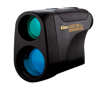

I will give you a great deal on a Nikon Rangefinder that I bought last season after I "lost" my original.... Needless to say, cleaning up my reloading bench after the season, I find a paper bag with all sorts of stuff in it, including my missing rangefinder...
The new one was one of these. Send me a PM if interested
