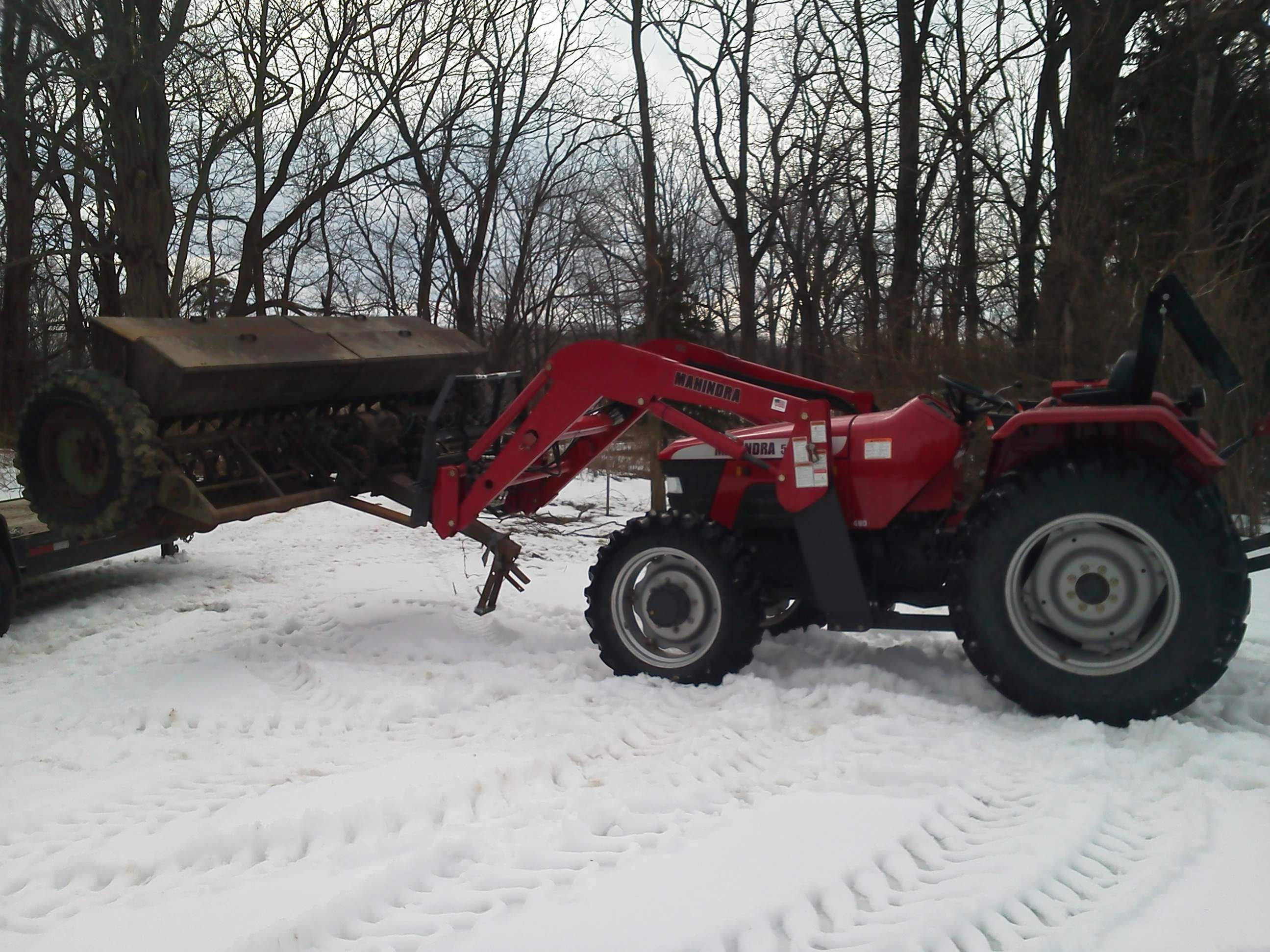

Yay! It got up to 57 today and the sun even came out. My neighbor and I went out to the property to unload some equipment we took out there last weekend. I bought a cultipacker and an old Oliver Superior seed drill. The Mahindra was able to pick them both off the trailer without any issues.

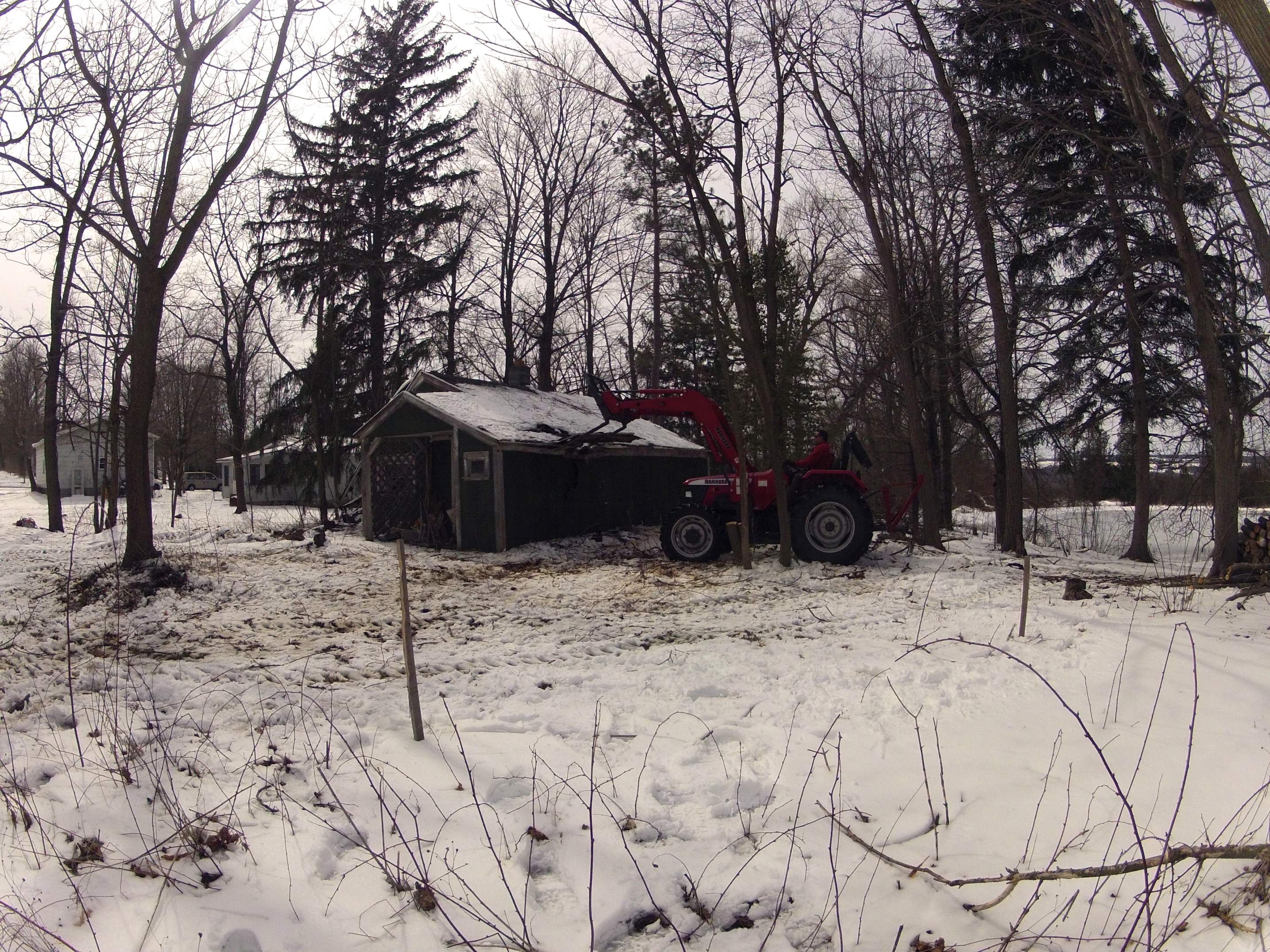

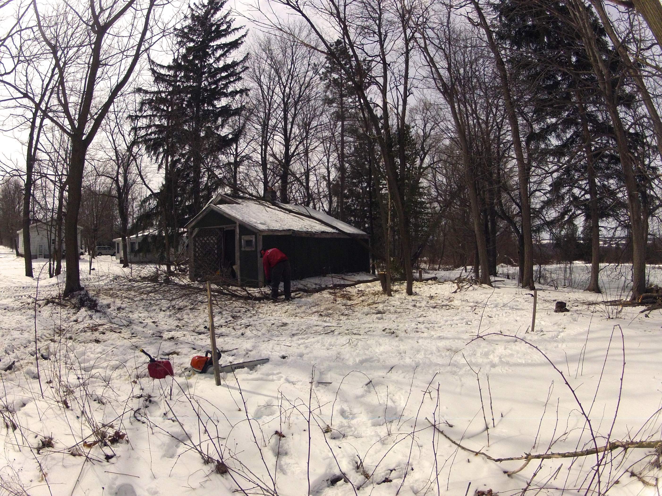

I managed to get a bit of seat time on the tractor. I decided that it would be nice to move the camper away from the road a bit. There was a dilapidated cabin/house just over the stream that would be a perfect location for the camper. So I broke out the smaller chainsaw (Stihl MS260pro) and began taking down the trees that had grown up within 10 feet of it. This way I would be able to get a machine in there at some point to demo the building. Well, I was going to fuel up the saw and realized that the only mixed gas I had was the small amount in the tanks of my two saws. My wife was kind enough to go get a gallon of gas and some 2-cycle oil, picked up lunch too! After we ate I went back out to finish up the tree removal, gassed up the saws, and discovered I was out of bar oil. Back into town went the wife, laughing at me as she walked to her car. After all the fluids were finally topped off I managed to remove enough trees to the point that I could get a machine next to the building.

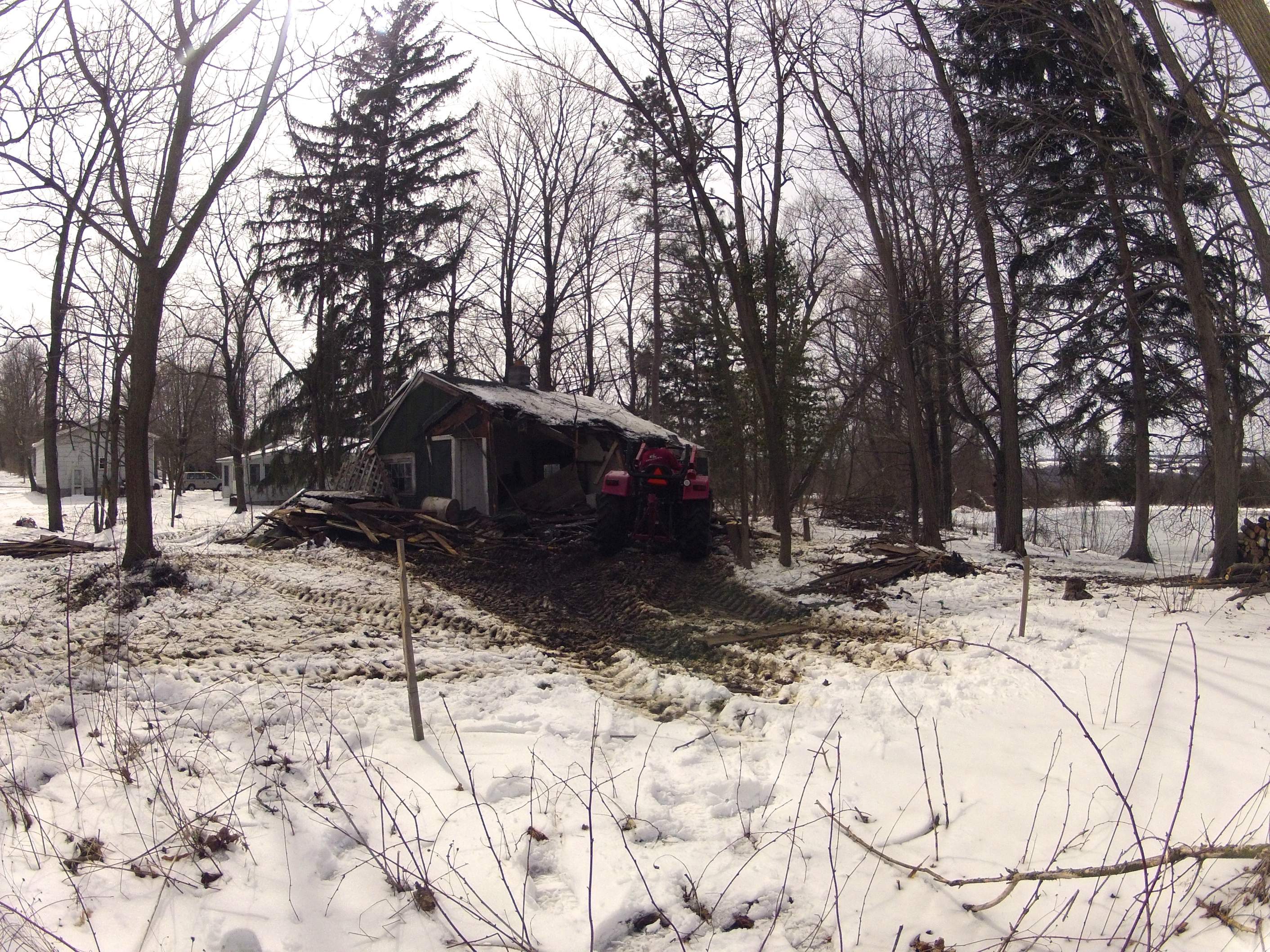

It was still early in the day and the women were on a roll inside the house with their cleaning/organizing so.... I did what any one of us on this forum would do and hopped on the tractor. First thought that came to mind was "I wonder if this has enough power to take down the building". Well, an hour later and it was on the ground. I started by sliding the forks up under the roof sheathing and lifting that off. Then I was able to set the forks on top of the walls and push down, breaking them into pieces. Some how I managed to not put a nail in my tires, I was very careful to keep the debris picked up/pushed out of the driving areas. There was one bee's nest in the last wall to come down. As it was only 34 degrees out they weren't too active. Here's a couple pics from yesterday:

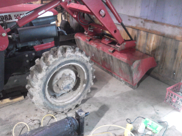

Good news, I found the hole. Looks like a nail was the culprit. I cleaned off the mud and circled the hole.
Then I took the weight off by using the front loader. This allowed me to spin the tire. Much easier working on it with the hole up.
Then it was just a matter of getting the ream through and opening the hole enough to accommodate the plug.
I put a plug on the plug tool, applied glue, inserted and pulled the tool out.
Ta-da! One repaired tire. I didn't even need to break down the tire and patch internally.
