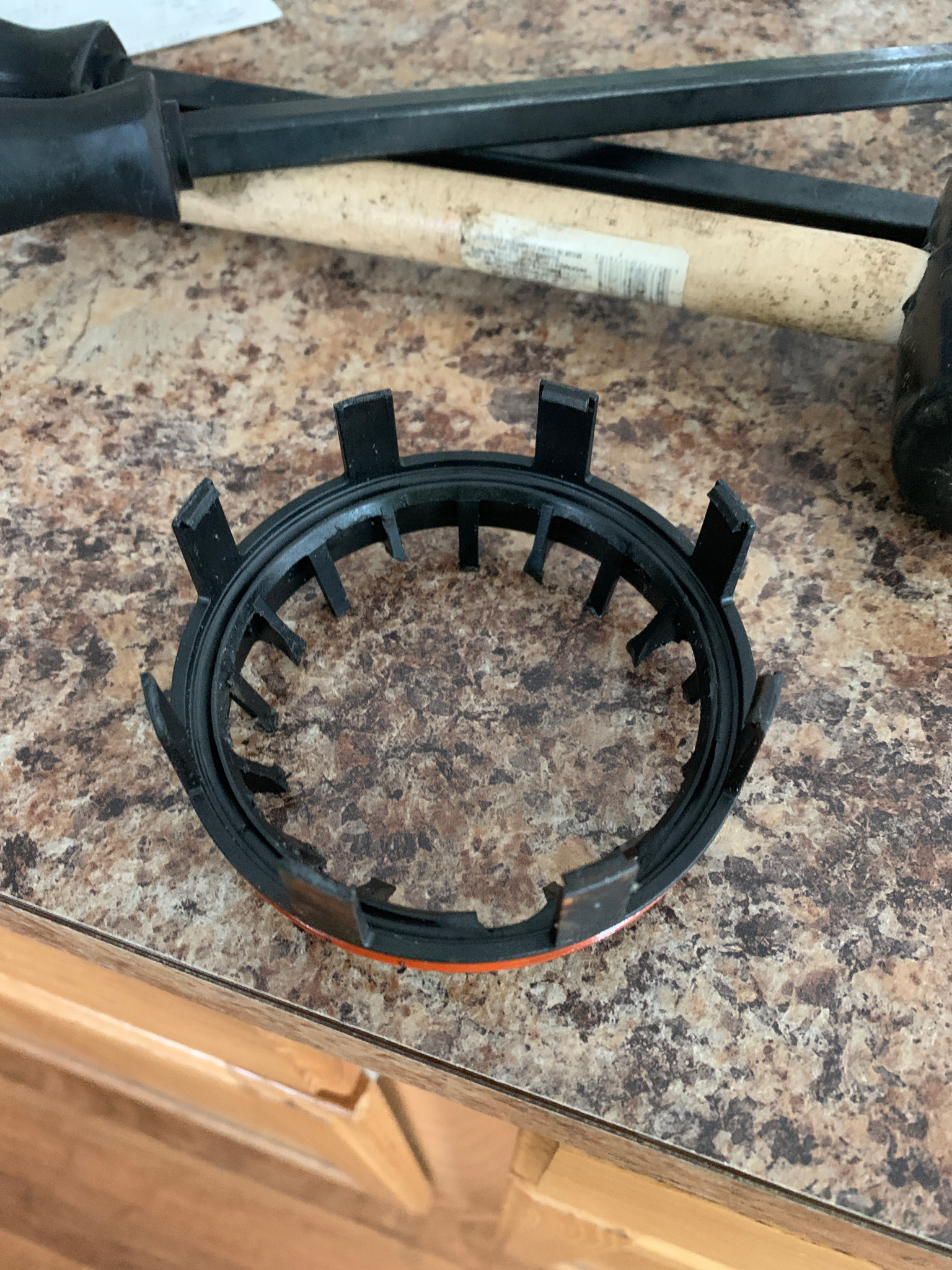

Hi all, certain someone here has dealt with this on a tow vehicle or can help regardless. Sorry again for posting to this forum. Manual locking hub plastic broke as I tried to replace the locking hub. Any idea how to get the gears out? I’m planning on drilling and trying to get out that way.
Thanks again
Joel

I've had mine apart over the years but not sure what I'm looking at? And what caused it to break?

The factory spin outs are plastic. I'm just not sure what caused the break? And I can't figure out the issue of removing the gears? Nor drilling holes?

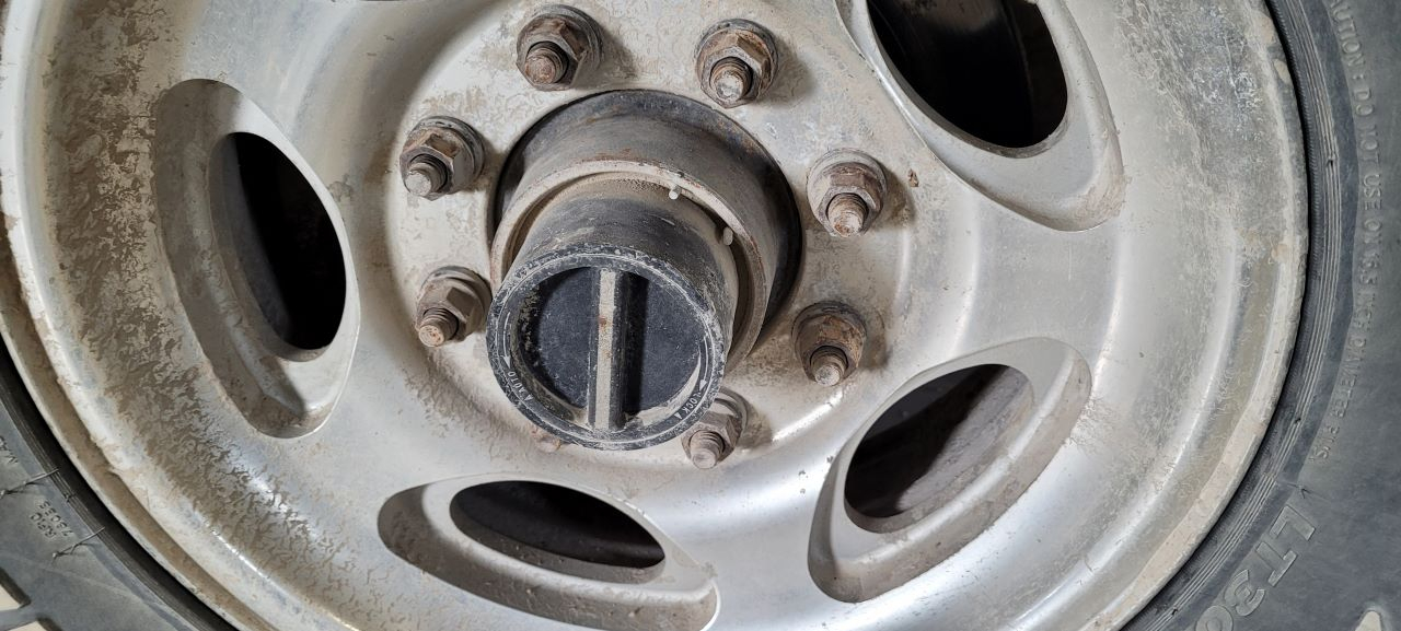

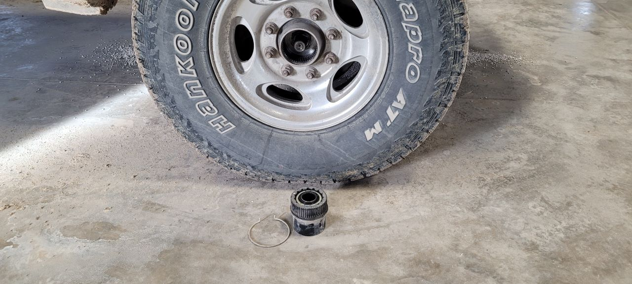

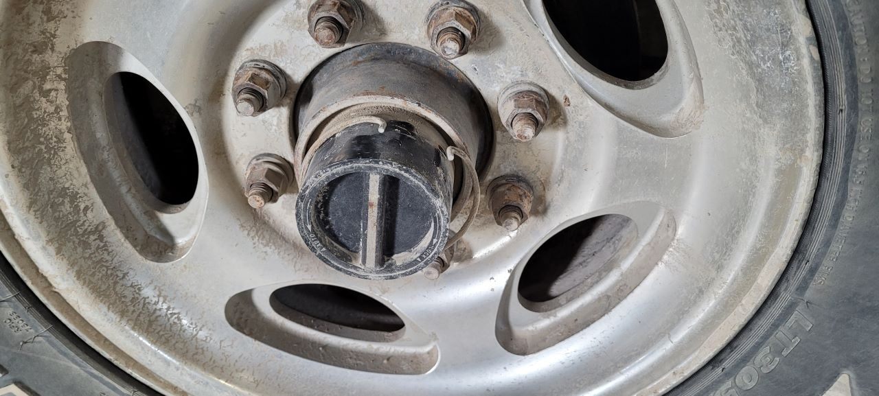

Here's a factory spin out on a '00 F250.
First pic is after removing the chrome lug nut cover.
Second pic is after removing the "snap ring" that holds the spin out to the wheel hub.
Third pic is with the spin out removed.
Only tool required was a large screw driver to pop off the chrome nut cover.
