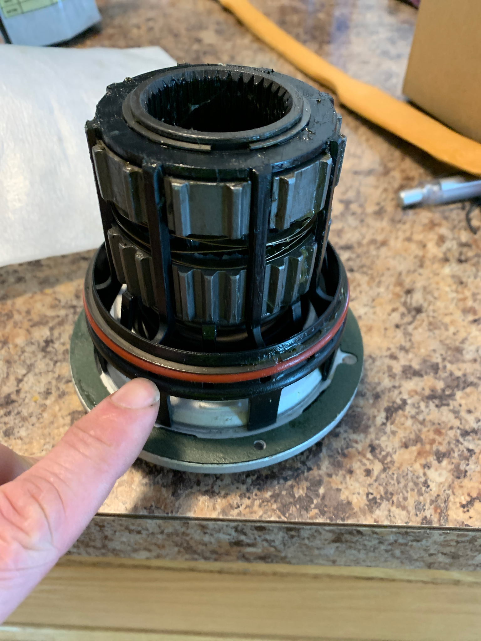

Well no surprise I post f250 question on a tractor forum and get more responses than if I had posted on Ford forum. thanks all!! Pic of new locking hub. Circled what broke on old which left gears in hub on axle. I PB Blasted then drove around. The locking gear popped out a bit and unlocked. I could grab with needle nose pliers and then was able to pull it out. I then was able to grab the plastic tabs and pull remaining gear set out. Of new doesn’t fit and need to order another. Thanks again!!

2016, 56k miles. Honestly a bit disappointed that they needed to be replaced so soon. The truck gets light, regular use. I guess either my expectations are too high or is true that some things aren’t built like they used to be. Also interesting how much plastic, maybe a must have?

The spin out I showed is '00 with 280K miles. Won't auto engage anymore. Both are original. Moderate use.
Your entire wheel hub assembly is different.
