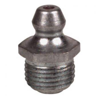

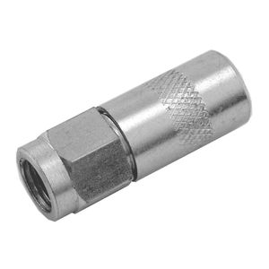

You don't need separate gun, just buy a 1/8 inch NPT zerk and screw it into the old coupler that you are using now. Lock onto it with the LockNLube and hold it into those places.

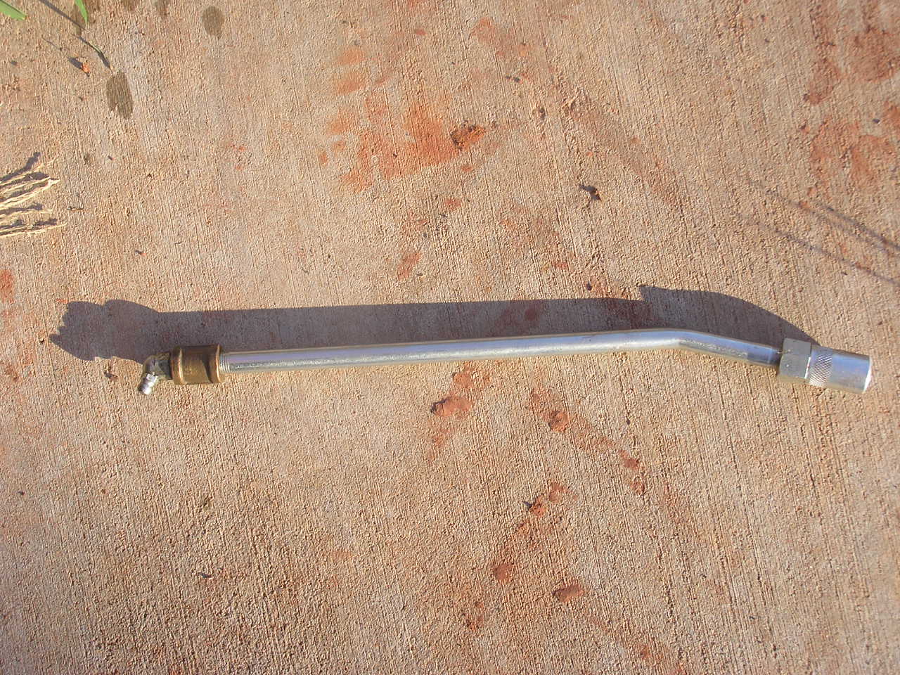

I made an extender from the pipe that I removed from the lever gun:
