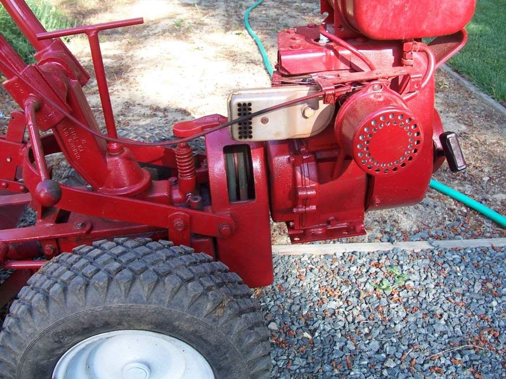

Thats correct Jeep, its an H60. Got a chance tonight to put a new spark plug in it, loosened up the carb linkage, changed the oil, (poured a cap into the cyl) sprayed in some ether, and cranked her over. Darned if she didn't start!! Had gas leaking out the bottom of the carb, and theres a cut in the fuel line, not sure if thats the same problem. Gonna change all the fuel lines, and look into a carb kit. THere was a nest underneath the engine cover, dust and junk spewing all over so didn't want to try to run it. Plus there was no air filter assembly on it. The engine manual, which covers go carts, and everything else shows parts for one, but not clear from what I've got if thats the case. Hey Jeep44 can check what you got on yours? Is it possible they didn't use one for snowblowers? I know my boat engine doesn't have an air filter. Thanks.
   / Look A Free Snow Blower #14
Well, as you might expect, my tiller has an air cleaner assembly on it-it needs it in the dusty air it runs in. I don't know if a snowblower would have one or not.It also has a breather hose that runs from the valve cover under the carb/muffler to a fitting in the back plate of the air cleaner. Does your motor have that breather hose? How would you keep snow from getting into the carb and stalling it out? Here is a photo of a tiller very similar to mine-I think it came from another thread in this forum, but it clearly shows the type of aircleaner I have on mine.
   / Look A Free Snow Blower #15
Snowblowers typically do not use an air filter. Some of the old machines were fitted with one if the "tractor" portion was intended to power attachments used in the summer when dirt and dust could be a problem.
   / Look A Free Snow Blower #16
This is correct.
